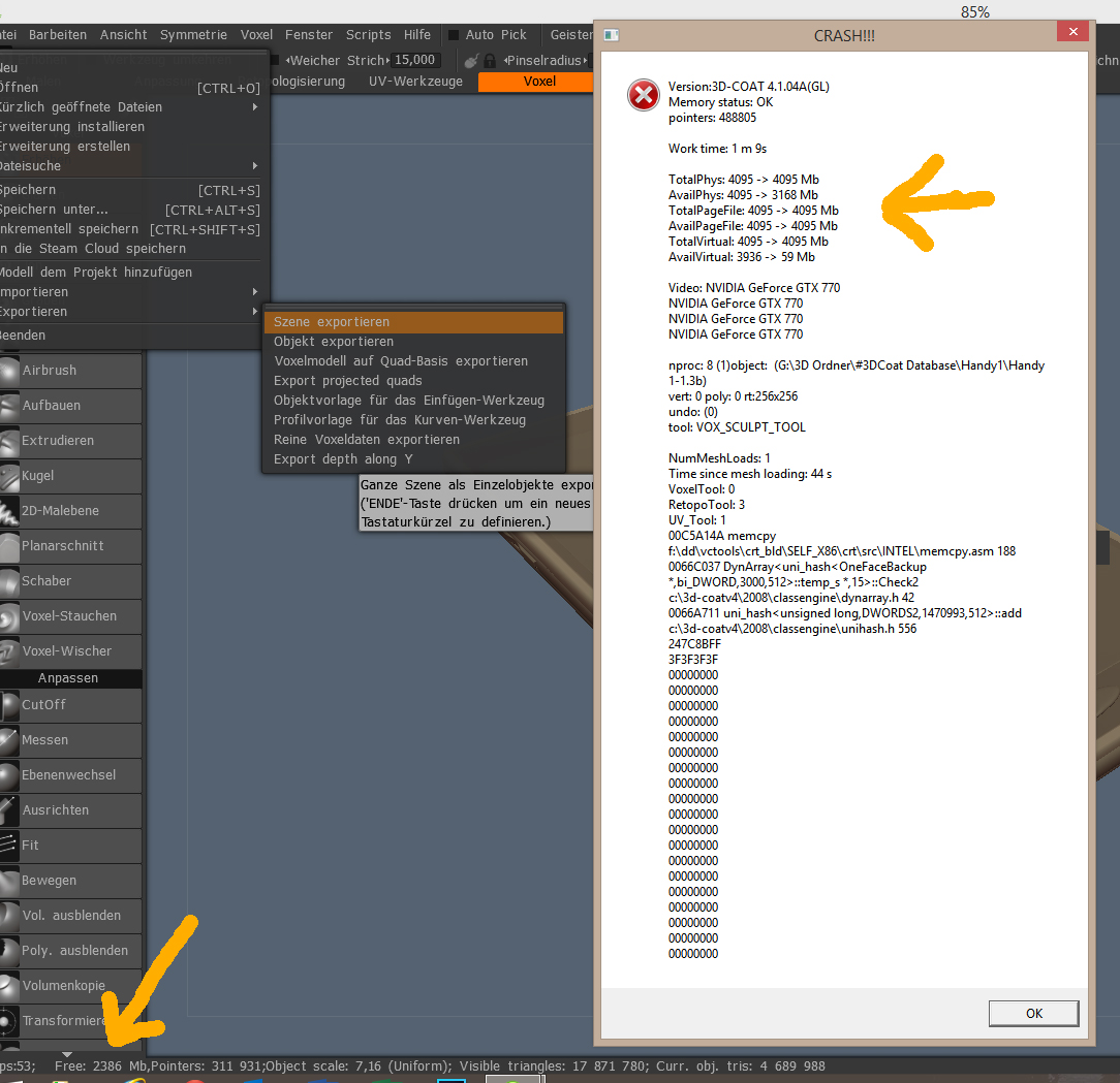

  2. Hello, I always get "out of memory" crashes with my Models. I set virtualspace in Windows 8.1 to 8 GB on one ssd and another 10 GB on one other drive. 3dcoat still says i have only 4 GB max. virtual space free (bottom left corner). Atm iam confused i need these bigger models what can i do ? I attached one picture of the problem.
