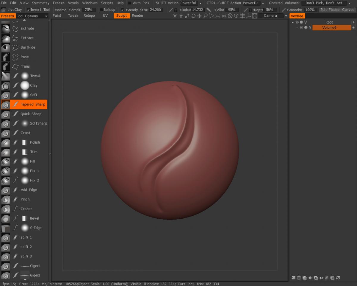

Contributor artman Posted October 7, 2014 Contributor Share Posted October 7, 2014 a little Tapered Sharp brush variation,maybe some of you will find it useful.... Really one of my main brushes those days, lenght is relatively short so you can't run it down the entire spine of a character for example but its much fun when doing wrinkles, hair strands ect... Tapered Sharp.3dcpack 4 Link to comment https://3dcoat.com/forum/index.php?/topic/10395-v41-beta-experimental-4117d/page/318/#findComment-113780 Share on other sites More sharing options...

Javis Posted October 7, 2014 Share Posted October 7, 2014 a little Tapered Sharp brush variation,maybe some of you will find it useful.... Really one of my main brushes those days, lenght is relatively short so you can't run it down the entire spine of a character for example but its much fun when doing wrinkles, hair strands ect... Tapered Sharp.3dcpack taps.jpg Nice brush! Thank you for sharing. Link to comment https://3dcoat.com/forum/index.php?/topic/10395-v41-beta-experimental-4117d/page/318/#findComment-113782 Share on other sites More sharing options...

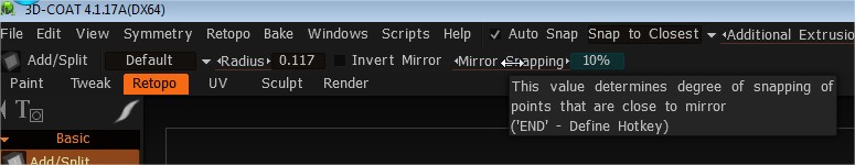

Advanced Member Aleksey Posted October 11, 2014 Advanced Member Share Posted October 11, 2014 It might be user error, but for me this still does not work correctly. 3DCoat always produces additional, unwanted vertices/ faces on the symmetry plane. What I'm talking about is this: I get this problem all the time. Ive generally just ended up either welding points at the end of the process. or exporting the retopo mesh and then welding points together in c4d, then bringing it back. quite frustrating. Link to comment https://3dcoat.com/forum/index.php?/topic/10395-v41-beta-experimental-4117d/page/318/#findComment-113831 Share on other sites More sharing options...
Carlosan Posted October 11, 2014 Share Posted October 11, 2014 Do you have virtual mirror mode = on if yes, you need to work ONLY in the right side of the model -with sym X on- when finish the manual retopo... do: Retopo menu > Apply Symmetry to current layer Link to comment https://3dcoat.com/forum/index.php?/topic/10395-v41-beta-experimental-4117d/page/318/#findComment-113833 Share on other sites More sharing options...
Advanced Member alvordr Posted October 11, 2014 Advanced Member Share Posted October 11, 2014 I get this problem all the time. Ive generally just ended up either welding points at the end of the process. or exporting the retopo mesh and then welding points together in c4d, then bringing it back. quite frustrating. That's not an error. It's usually caused by placing one vert beyond the symmetry plane. If you pull it the other way, you'll notice a hole. Link to comment https://3dcoat.com/forum/index.php?/topic/10395-v41-beta-experimental-4117d/page/318/#findComment-113834 Share on other sites More sharing options...
Advanced Member Aleksey Posted October 11, 2014 Advanced Member Share Posted October 11, 2014 (edited) is there a tutorial that explains the various mirror modes? its been giving me issues since i started 3d coat. i remember initially i was getting wierd poly's along the middle, not like this, but like extruded down into the mesh. the virtual mirror option fixed that i think. ah well, more experimenting. thanks for the help. edit: would be nice if verts on top of each other auto welded.. wouldnt it? Edited October 11, 2014 by Aleksey Link to comment https://3dcoat.com/forum/index.php?/topic/10395-v41-beta-experimental-4117d/page/318/#findComment-113835 Share on other sites More sharing options...
Carlosan Posted October 11, 2014 Share Posted October 11, 2014 Purpose of retopo virtual mirror mode ? and Link to comment https://3dcoat.com/forum/index.php?/topic/10395-v41-beta-experimental-4117d/page/318/#findComment-113837 Share on other sites More sharing options...
Reputable Contributor AbnRanger Posted October 12, 2014 Reputable Contributor Share Posted October 12, 2014 is there a tutorial that explains the various mirror modes? its been giving me issues since i started 3d coat. i remember initially i was getting wierd poly's along the middle, not like this, but like extruded down into the mesh. the virtual mirror option fixed that i think. ah well, more experimenting. thanks for the help. edit: would be nice if verts on top of each other auto welded.. wouldnt it? Just like having verts weld at the center of the symmetry plane (when using the Symmetry modifier), you have to adjust the "Mirror Snapping" at the top of the UI for 3D Coat to even know you want them welded within a given range. Before doing any work along the Symmetry Plane, adjust it to 20-40%. Andrew should change the default value to 25% or so. That way there are fewer issues in this regard. 1 Link to comment https://3dcoat.com/forum/index.php?/topic/10395-v41-beta-experimental-4117d/page/318/#findComment-113840 Share on other sites More sharing options...
Advanced Member alvordr Posted October 12, 2014 Advanced Member Share Posted October 12, 2014 is there a tutorial that explains the various mirror modes? its been giving me issues since i started 3d coat. i remember initially i was getting wierd poly's along the middle, not like this, but like extruded down into the mesh. the virtual mirror option fixed that i think. ah well, more experimenting. thanks for the help. edit: would be nice if verts on top of each other auto welded.. wouldnt it? They do, but only if you're near enough for them to snap. You can change snap settings found as AbnRanger noted. Otherwise, to weld them you can simply stack one on top of the other. Link to comment https://3dcoat.com/forum/index.php?/topic/10395-v41-beta-experimental-4117d/page/318/#findComment-113844 Share on other sites More sharing options...
