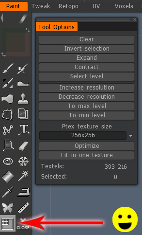

There is a button in the tool palette which says Ptex local resolution when you hover over it. It's an image of a square with four smaller squares in the upper left corner of it. Clicking on it will bring up a bunch of options, at which point you can select which polygons you want to affect by left clicking on them (hold control key and left click to deselect).
post-9206-0-36049100-1368780340_thumb.pn
