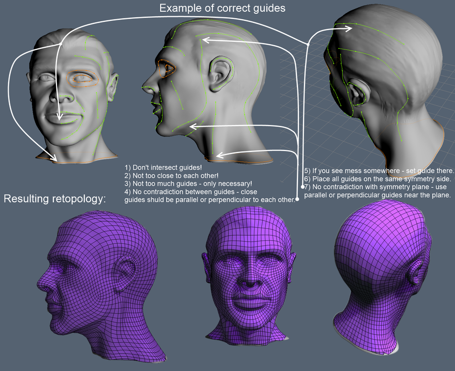

Uncheck the hard-surfaces option in the dialog and see if that doesn't help. Plus here is a guide to getting better Auto Retopo results. Sometimes it's the bees knees, and other times it can be a bit fussy.
post-1118-0-41653600-1400502670_thumb.pn
