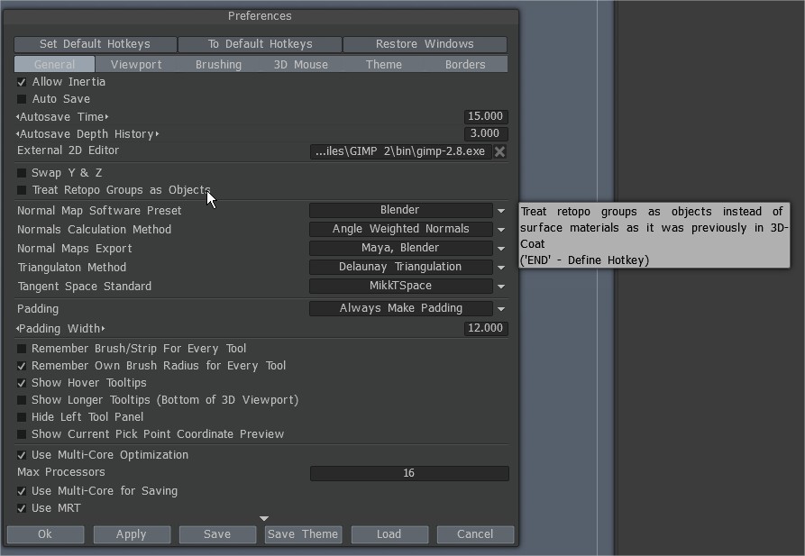

Carlosan Posted October 15, 2014 Share Posted October 15, 2014 you apply different material to every layer before export and is not working ? is a obj or a fbx ? preferences > retopogroups is on or off ? Quote Link to comment https://3dcoat.com/forum/index.php?/topic/16749-mesh-rendering/#findComment-113933 Share on other sites More sharing options...

Carlosan Posted October 16, 2014 Share Posted October 16, 2014 hope this help http://3d-coat.com/forum/index.php?showtopic=16412 Quote Link to comment https://3dcoat.com/forum/index.php?/topic/16749-mesh-rendering/#findComment-113958 Share on other sites More sharing options...
