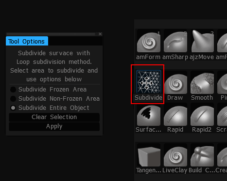

Member kitsune0 Posted November 23, 2015 Author Member Share Posted November 23, 2015 I went up as high as eight subdivision levels with import tool's subdivide button and 9 levels with subdivide tool. After that, it simply wasn't worth to wait for the result as the geometry was already so dense, that working with it didn't make any sense. The advice I can give you is that if you're subdividing your surface with the Res+ tool - then stop! Use this tool only for increasing resolution of voxel volumes. For subdividing surfaces use the mentioned Subdivide button (available in the Import tool), or the Subdivide tool. You said that want to go as high as 10-15 subdivisions with your low-poly mesh. I strongly discourage it. Do you realize that the polycount of a simple 6-sided cube at 10th subdivision level reaches 12 582 912 triangles, and at 15th level - 12 884 901 888 (almost 13 billion triangles)? If your initial low-poly model has even a mere 10 or 20 faces more then... Well you get the picture. Why do you need so much global resolution on your mesh anyway? Are you aware that surface LiveClay tools are capable of real-time local subdivision? My suggestion is to subdivide your mesh only a couple of times and let the LiveClay tools do the magic. Why would I want to do something isnt really the topic here. I dont think that only 6 subdivisions is really that high if you are really sculpting small details. The point here is that, if you look to the screenshots, the cube breaks in the 6th subdivision. OBVIOUSLY, my workflow doesnt include a cube, that was just an easy example for people to test if it does crash. Take into account that must be in surface mode to "break". Due the workflow Im using, I cant use liveclay plus liveclay always leave a lot of weird vertex that translates to dark spots on meshes (probably vertexs with more than 5 edges). I know there are some tools to clean the mesh but still, searching a different way of doing something that should work in first instance isnt a "fix" and just a workaround. I would like to know why it does happens and why it gets sorted if I clear memory after the 5th subdivision and if is a common bug that happens to everyone or if is tied to something else because I installed all versions since 19 to 23 and in all of them happens :S. Thanks for the reply tho. Are you using this tool ? Yeah that one. Sometimes I access it through the left panel or using space bar. Quote Link to comment https://3dcoat.com/forum/index.php?/topic/18585-3d-coat-breaks-mesh-after-5-or-6-subdivisions/#findComment-129000 Share on other sites More sharing options...

Member kitsune0 Posted November 23, 2015 Author Member Share Posted November 23, 2015 Like I said, don't use the Res+ tool, or that button Carlos pointed to (which is a shortcut to Res+ tool). The problem you describe occurs at sixth iteration of the Res+ when it's used to increase the resolution of a VoxTree layer that is in surface mode. Thank you but, which button should I use? I have started using 3D Coat recently but I didnt know that were different ways of subdividing the mesh. I know that same button appears on the left panel as well as hitting space bar to see shortcuts and its also on the geometry top menu. Which button or option should I use? Also, would cleaning memory have any negative impact in the workflow? Im not sure if you can go back and forward through subdivisions levels like Mudbox but the last I heard is that you cant so not sure if cleaning memory would kinda make it impossible to go back if were the case. Thank you. Quote Link to comment https://3dcoat.com/forum/index.php?/topic/18585-3d-coat-breaks-mesh-after-5-or-6-subdivisions/#findComment-129003 Share on other sites More sharing options...
Contributor ajz3d Posted November 23, 2015 Contributor Share Posted November 23, 2015 (edited) If you want to subdivide the object before importing it to sculpt room: Subdivide uses Catmul-Clark's algorithm. Flat subdivision doesn't. If you want to subdivide an already imported object: This one uses loop subdivision. --- I never had to do the memory cleanup. Maybe it has some uses, but I now nothing about them, I'm afraid. Maybe someone else could tell more. You can't switch between subdivision levels while sculpting per se. There's a proxy mode that you can use which will temporarily decimate / reduce the geometry specified amount of times. See Geometry->Proxy Method for selecting the proxy method and the amount of decimation / reduction. To cache / uncache the volume (to proxy /unproxy it) use either this icon: or the Geometry->Caching menu. ALWAYS do a backup of the layer you intend to cache. Remove the backup when you have unproxied the original layer and are absolute sure it's undamaged. I've seen proxy fail several times (lost some work because of that). Edited November 23, 2015 by ajz3d Quote Link to comment https://3dcoat.com/forum/index.php?/topic/18585-3d-coat-breaks-mesh-after-5-or-6-subdivisions/#findComment-129006 Share on other sites More sharing options...
