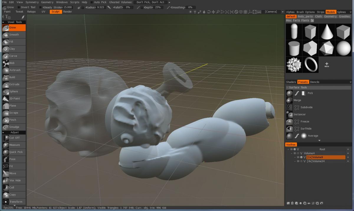

I'm sure this is a total newb question, and I apologize if the answer is really obvious.
I've been watching a few tutorials on UV unwrapping as I try out 3D Coat, and all of them show the workflow for unwrapping as:
1. Import/sculpt the model.
2. Click the UV tab & start the UV unwrapping process.
However, this doesn't work for me as I am never able to get to the second step. In multiple different files, when I click the UV tab nothing is there. I've look through all the menus I could find, tried converting from V TO S, and looked through Google for this answer and found nothing. Anyone know what's going on here?
All help would be appreciated.
Thanks much!
Aaron

Hey Tony, I tried using autopo & did some manual retopologizing. I then unwrapped it from the retopo > unwrap menu, and the UV tab is still empty!
Are there any tutorials or workflow on this at all? What is the "surface materials" tab on the RHS for, and what does that have to do with UVs? This is the closest thing to the voxtree in the UV tab, and it always only shows the scene (see picture above). I seems like there should be something a lot more clear & straightforward that I am missing...
