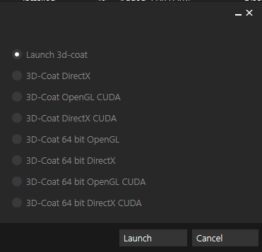

New Member Dezzlor Posted February 13, 2016 New Member Share Posted February 13, 2016 Hi, ive been trying to use the program for a while now, ive clocked around 120 hours on steam with it and even now i cant seem to finish my work because it keeps saying i should increase the amount of virtual memory. ive tried to do this, but 3dcoat just says theres only 1786 free of memory. ive included some pictures. could you help me? The problem occurs when im trying to edit projections in photoshop, but then when i save it and it tries to import all of the files it then crashes. have i done something wrong? Thanks! P.S. if its not clear, im kinda a noob when it comes to this. Also, sorry if this post is in the wrong area, im also new to this forum! Quote Link to comment Share on other sites More sharing options...
Reputable Contributor Solution digman Posted February 13, 2016 Reputable Contributor Solution Share Posted February 13, 2016 (edited) You must be running the 32 bit version of 3DC... Please run the 64 bit version to gain access to all your 16 gig of system ram. Check the top Left corner of 3DC to see which version you are running, shown in attached image. Look under All Programs / 3d-Coat-V4.5 to find the 64 bit version of 3DC. Edited February 13, 2016 by digman 1 Quote Link to comment Share on other sites More sharing options...
New Member Dezzlor Posted February 13, 2016 Author New Member Share Posted February 13, 2016 i cant believe its that simple. Which one do i chose? im doing it via steam Quote Link to comment Share on other sites More sharing options...
Reputable Contributor digman Posted February 13, 2016 Reputable Contributor Share Posted February 13, 2016 (edited) Try the 64 bit DX version... later you can test 64 bit GL or Cuda versions to see which of the 3 version types run the best for your computer and graphics card. Edited February 13, 2016 by digman Quote Link to comment Share on other sites More sharing options...
New Member Dezzlor Posted February 13, 2016 Author New Member Share Posted February 13, 2016 Massive massive improvement, thank you so much!! Quote Link to comment Share on other sites More sharing options...
