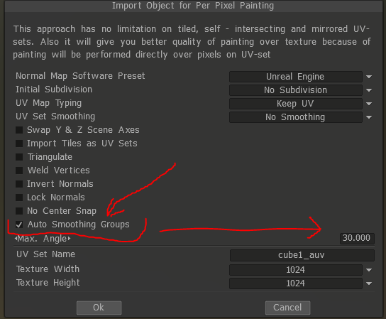

Try selecting auto-smoothing groups in the import panel. Default is 30 for the angle between faces. Test what works best for your model.
Attached image shows the auto-smoothing groups.
EDIT:
I imported a lightwave file format. Exported from Wings3d as an Lwo file.
The model on the left was imported without using auto-smoothing groups
Model on the right side of the attached image was using auto-smoothing groups set to 30 degrees. That matches the model in Wings3D.
