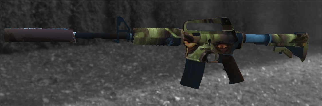

Member videogameronline Posted June 2, 2016 Member Share Posted June 2, 2016 So I use 3d coat to help with making skins for the game csgo. (counterstrike global offensive) The problem is on a few obj weapon models there are invisible spots were the gun is just not rendered in 3d coat. This in turn translates to being nothing (checkered background) in photoshop when I send to edit in external editor. Also when I look at this same area of the model from another angle it displays correctly. It seems one side of this polygon is invisible while the other side works as it should. Ultimately it turns into a white triangle on the finished product. Any ideas on what's happening here? I'm using the steam version of 3dcoat with windows 10, Nvidia 970 graphics card, 3770k cpu. The p Quote Link to comment https://3dcoat.com/forum/index.php?/topic/19452-invisible-polygons/ Share on other sites More sharing options...

Member videogameronline Posted June 4, 2016 Author Member Share Posted June 4, 2016 18 hours ago, Carlosan said: The new stable version is v4.5.40 with several bug fixes Please point me to the model download link, i like to try opening it. ty http://tf3dm.com/3d-model/m4a1-s-62327.html Here's the link to just the m4a1s. This is the obj I'm trying to use, but it's not this specific download that's the problem. It doesn't work through valves official download link either. Also the desert eagle model seems to have the same bugs with 3dcoat. http://blog.counter-strike.net/workshop/resources.html This link provides you with pretty much everything else you need. I'm using 3dcoat version 4.5.19 because that's the newest update on steam. Quote Link to comment https://3dcoat.com/forum/index.php?/topic/19452-invisible-polygons/#findComment-135875 Share on other sites More sharing options...
Carlosan Posted June 4, 2016 Share Posted June 4, 2016 Do you edited the model first ? It have holes in all the geometry. And dont have an assigned material, please try with attached version. ty m4a1.zip Quote Link to comment https://3dcoat.com/forum/index.php?/topic/19452-invisible-polygons/#findComment-135895 Share on other sites More sharing options...
Member videogameronline Posted June 4, 2016 Author Member Share Posted June 4, 2016 I didn't edit the geometry at all. This is just how it was in the official csgo download. I don't really use 3dcoat to edit the geometry of 3dmodels. I just use 3d coat to paint models. The version you attached worked perfectly! What did you do differently? Quote Link to comment https://3dcoat.com/forum/index.php?/topic/19452-invisible-polygons/#findComment-135911 Share on other sites More sharing options...
Carlosan Posted June 4, 2016 Share Posted June 4, 2016 Using Blender I closed holes and assigned a material. The UVMap was ok. glad to help Quote Link to comment https://3dcoat.com/forum/index.php?/topic/19452-invisible-polygons/#findComment-135913 Share on other sites More sharing options...
