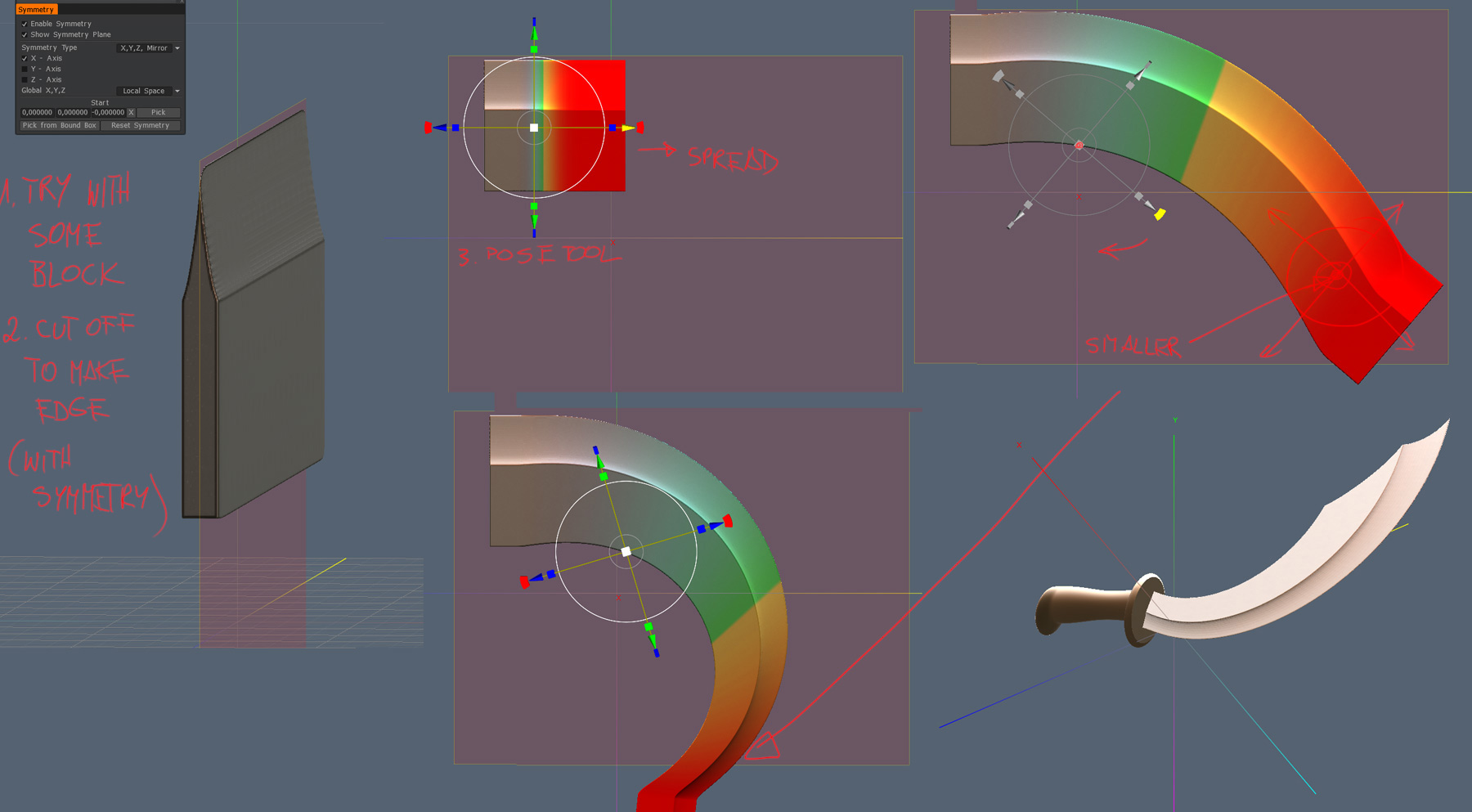

Advanced Member Wojtek Kapusta Posted October 24, 2016 Advanced Member Share Posted October 24, 2016 Hi, I think there are more than one possibility for doing something similar you described, I would try this way... I prepared some simple example, hope it helps a little Quote Link to comment Share on other sites More sharing options...
New Member itsateben Posted October 24, 2016 Author New Member Share Posted October 24, 2016 Thanks for the reply, Wojtek. I'll give it a shot with this method. Maybe I could use this method on different portions and then recombine them. Quote Link to comment Share on other sites More sharing options...
