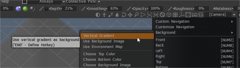

Carlosan Posted November 18, 2016 Share Posted November 18, 2016 Hi ! Hope this help. Set contrast = 0 camera > background > vertical gradient toggle orthographic proyection //edit: ortho viewport with the numpad 5 key, yes. Quote Link to comment https://3dcoat.com/forum/index.php?/topic/20356-difficulty-painting-underside-of-mesh/#findComment-141686 Share on other sites More sharing options...

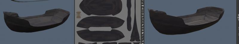

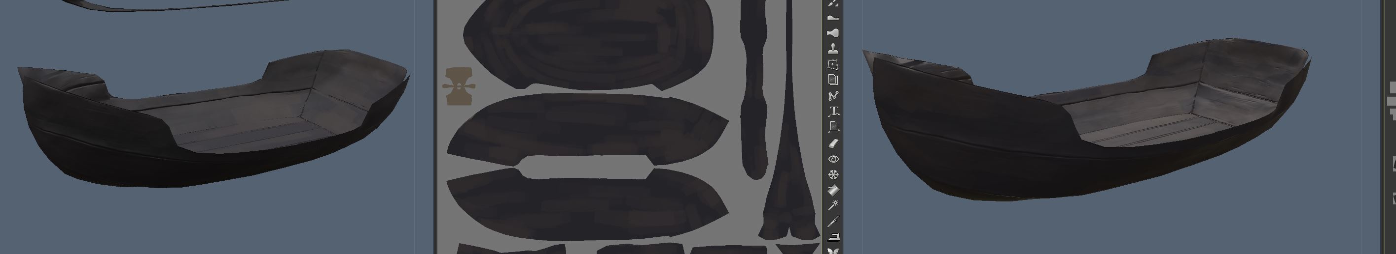

Member Beddall Posted November 18, 2016 Author Member Share Posted November 18, 2016 hmm i guess it could be, but mine seems to be affected by the roughness map. . the behaviour i'm seeing is as follows. currently my roughness texture is pure white (100%) in the texture editor. if i paint on the model using only roughness channel (100%)... then it alters the appearance of the material on the 3d model. it also then displays the diffuse correctly in the texture editor, but only where i have painted. the roughness texture doesn't change as it's still pure white. It's definitely broken in some way. ------------- I think something must have happened to the materials... because if i set them up to be identical in both 4.5 and 4.7 they look quite different. Exactly same settings across the board, scene set up, lighting texture values... here is a pic. 4.7 is on the left and 4.5 on the right. Quote Link to comment https://3dcoat.com/forum/index.php?/topic/20356-difficulty-painting-underside-of-mesh/#findComment-141698 Share on other sites More sharing options...
