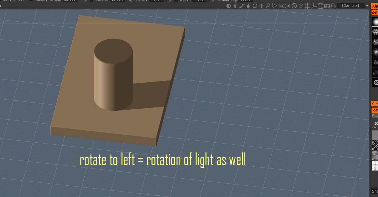

Member Lyno Posted March 14, 2017 Author Member Share Posted March 14, 2017 Hello digman, Thank you for your reply and the channels you provided. I was hoping there was a more in depth user manual like you can find with 3dsMax. Anyway, I'm sure I'll learn a lot from those videos. I'm using version 4.7.24(GL64) as a trial. I've included some steps to show what I exactly mean. In step 1 I've created a cylinder on a plane, checked 'cast shadows' from the Geometry menu and I'm able to rotate the light using the 'adjust light icon' top right toolbar. Now, when I start rotating my camera in step 2, the light also rotates with it, but I want it on a fixed position. Thanks, I hope this clarifies it a bit. Quote Link to comment Share on other sites More sharing options...
Reputable Contributor digman Posted March 14, 2017 Reputable Contributor Share Posted March 14, 2017 (edited) Now I understand better thanks... This would be a design feature as the light is tied to the camera for sculpting purposes. As we spin around the model the light follows so we can see better what we are sculpting. There is no way to currently that I know of to unlock the light from the camera. You could create a feature request for that ability. Personally, I rather have the light follow the camera as the default setup but also can see uses of unlocking the light. Feature requests, Andrew does listen and many features we have today are from feature request. The most recent was getting rid of sphere placement for locally adjusting your baking cage to a paint method which is far far better and user friendly. Depending upon his development schedule and the reasons given for the feature plus other users jumping in and giving the old "+1" to your request helps. Edited March 14, 2017 by digman Quote Link to comment Share on other sites More sharing options...
