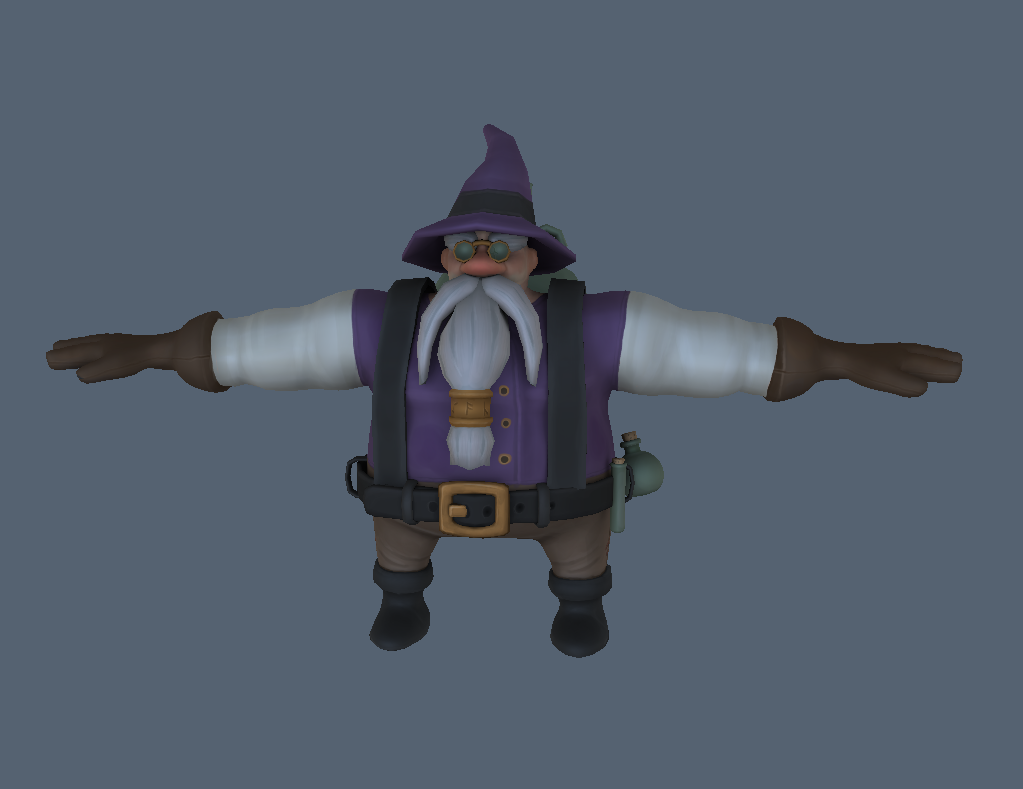

Member TallBhoy Posted June 10, 2017 Member Share Posted June 10, 2017 Hey I'm currently tying out the "Calculate Occlusion" tool on a few of my models but have run into a problem on one of them. The occlusion map produced has a lot of ugly sort of patches all over it. I ran the tool on a very similar model and never had any issues. I have all layers, paint objects and surface materials unlocked. I have attached images of the before and after of the model with errors and the similar model without. Any help on how to solve this issue would be much appreciated. Thanks. Quote Link to comment Share on other sites More sharing options...

Member TallBhoy Posted June 10, 2017 Author Member Share Posted June 10, 2017 (edited) 57 minutes ago, Carlosan said: Hi ! Are you using the latest version ? The model is very tiny ? Separate Paint Objects is = ON ? Tried all the solutions above but still happening . I updated to 4.7.24 as I was out of date. I don't have the option to tick "separate paint objects" and I tried scaling the character up by a lot. I have also tried re-importing the model without any textures applied and I still get the exact same effect happening. Edited June 10, 2017 by TallBhoy Quote Link to comment Share on other sites More sharing options...

Carlosan Posted June 10, 2017 Share Posted June 10, 2017 Reported as bug, -please dont delete the Gdrive share, thx- I found 2 issues with this project. Baking the AO give errors -looks as some UV overlapped issue- The original Scene Scale is very high, after changing it the model with the default values is very small. Because the model is tiny, in tweak room i cant select it to scale up, could be nice to have a command option to select all and scale all. Scaling up the model (+100%) in external app and importing it in new fresh PPP project... still give AO bake errors. Quote Link to comment Share on other sites More sharing options...
