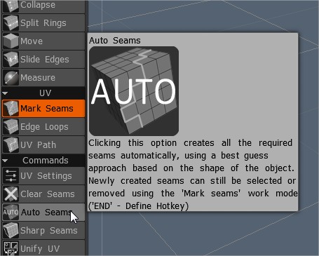

Carlosan Posted October 30, 2017 Share Posted October 30, 2017 The Decimate autoRetopo feature is really great as it manages to preserve any sharp edges on your models -access this command pressing RMB over the layer-. Then in Retopo room, use Autoseams to create the uv islands, bake and paint the model directly in Paint Room. Hope this help. Quote Link to comment Share on other sites More sharing options...

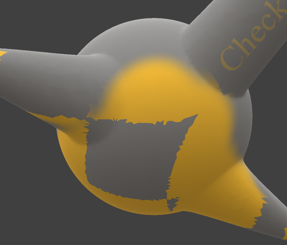

Advanced Member Metin Seven Posted October 30, 2017 Author Advanced Member Share Posted October 30, 2017 Thanks, @Carlosan, that worked. I'm almost there now. There's just one more issue: certain parts of the UV map don't receive paint. See the attached screenshot. Quote Link to comment Share on other sites More sharing options...
Advanced Member Metin Seven Posted October 30, 2017 Author Advanced Member Share Posted October 30, 2017 (edited) Hmm, it's even weirder — as I orbit around the model, the visible paint flips to the other UV parts. Might this be a bug of the 4.8.3 beta for Mac OS that I'm using? Otherwise I could try to revert to the default Mac OS driver for my NVidia graphics card. I'm currently using NVidia's latest Web driver. Edited October 30, 2017 by Metin Seven Quote Link to comment Share on other sites More sharing options...
Carlosan Posted October 30, 2017 Share Posted October 30, 2017 Try testing the workflow in a new fresh scene without surface paint any model before. Quote Link to comment Share on other sites More sharing options...
Reputable Contributor Fluffy Posted October 30, 2017 Reputable Contributor Share Posted October 30, 2017 1 hour ago, Metin Seven said: Hmm, it's even weirder — as I orbit around the model, the visible paint flips to the other UV parts. Might this be a bug of the 4.8.3 beta for Mac OS that I'm using? Otherwise I could try to revert to the default Mac OS driver for my NVidia graphics card. I'm currently using NVidia's latest Web driver. Just a hunch but I've seen similar behavior in 3D Coat when there are multiple copies of the same paint object (since they both occupy the same space sometimes the unpainted version will render over the top of the painted one and vice versa, this usually results in the object flickering and the texture appearing and disappearing on different parts of the model as you move the camera). Check your Paint Objects palette and make sure you don't have multiple copies of the object visible. Quote Link to comment Share on other sites More sharing options...

Advanced Member Metin Seven Posted October 31, 2017 Author Advanced Member Share Posted October 31, 2017 Hi @Carlosan and @Fluffy, I've tried it again today, and it worked (see my attached artistic masterpiece). Thanks a lot! I checked if there were multiple objects in the Paint Objects, and there was only one, but I guess the problem was that I had already painted on the model using vertex colors, before switching off Show Voxels In Paint Room. Have a nice evening, Metin 1 Quote Link to comment Share on other sites More sharing options...
