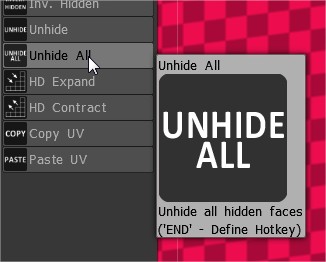

Member chippwalters Posted November 19, 2017 Member Share Posted November 19, 2017 I'm trying to mark some UV edges and cannot because the model goes 'behind' another mesh. Is there anyway to 'hide' the mesh associated with an island OR use wireframe view mode in the UV room? Choosing view Wireframe doesn't work for me in 4.8.03 Quote Link to comment https://3dcoat.com/forum/index.php?/topic/21664-how-to-hide-an-island-when-uv-mapping/ Share on other sites More sharing options...
Carlosan Posted November 20, 2017 Share Posted November 20, 2017 You mean this ? 1 Quote Link to comment https://3dcoat.com/forum/index.php?/topic/21664-how-to-hide-an-island-when-uv-mapping/#findComment-149438 Share on other sites More sharing options...
Member chippwalters Posted November 22, 2017 Author Member Share Posted November 22, 2017 Thanks! Never knew that was there Also, Is there a way to 'shuffle' the UV coloring used on the mesh? Sometimes, especially when an island is colored green, it becomes hard to see the seams. Thanks again! Quote Link to comment https://3dcoat.com/forum/index.php?/topic/21664-how-to-hide-an-island-when-uv-mapping/#findComment-149481 Share on other sites More sharing options...
Member chippwalters Posted November 22, 2017 Author Member Share Posted November 22, 2017 Hi Carloson, Turns out I'm having a bit of a problem with the hide command. Islands HIDE just fine, but when I try and UNHIDE, only part of the mesh returns. See this video: Here's the file if you want to try it yourself: https://filedn.com/lLMW4jXsJqxXkRYjd1UCoKL/3d/WallCandle.obj Quote Link to comment https://3dcoat.com/forum/index.php?/topic/21664-how-to-hide-an-island-when-uv-mapping/#findComment-149482 Share on other sites More sharing options...
Carlosan Posted November 22, 2017 Share Posted November 22, 2017 A way to 'shuffle' the UV coloring used on the mesh is to use the command colors. And then change the first top left color. Quote Link to comment https://3dcoat.com/forum/index.php?/topic/21664-how-to-hide-an-island-when-uv-mapping/#findComment-149484 Share on other sites More sharing options...
Carlosan Posted November 22, 2017 Share Posted November 22, 2017 Unhide only affects the selected islands To reveal all chose Unhide All Quote Link to comment https://3dcoat.com/forum/index.php?/topic/21664-how-to-hide-an-island-when-uv-mapping/#findComment-149486 Share on other sites More sharing options...
Member chippwalters Posted November 22, 2017 Author Member Share Posted November 22, 2017 I did use UNHIDE ALL. It didn't work. See video at 55 seconds. Quote Link to comment https://3dcoat.com/forum/index.php?/topic/21664-how-to-hide-an-island-when-uv-mapping/#findComment-149496 Share on other sites More sharing options...
Carlosan Posted November 22, 2017 Share Posted November 22, 2017 Is working fine from my side. Please try again but deselect any island first. Or select all hidden islands (Shift + LMB) and press Unhide. Quote Link to comment https://3dcoat.com/forum/index.php?/topic/21664-how-to-hide-an-island-when-uv-mapping/#findComment-149499 Share on other sites More sharing options...
Member chippwalters Posted November 22, 2017 Author Member Share Posted November 22, 2017 Calosan, Please review this very SHORT video. It appears there is a bug in UNHIDE ALL. Your second solution, where I select the island and press UNHIDE (not UNHIDE ALL) does work however. If you're interested in identifying the bug for yourself, please review with the obj I posted above. Quote Link to comment https://3dcoat.com/forum/index.php?/topic/21664-how-to-hide-an-island-when-uv-mapping/#findComment-149508 Share on other sites More sharing options...
Carlosan Posted November 22, 2017 Share Posted November 22, 2017 Bug reported. Thx ! Clear button add some issue. Quote Link to comment https://3dcoat.com/forum/index.php?/topic/21664-how-to-hide-an-island-when-uv-mapping/#findComment-149511 Share on other sites More sharing options...
