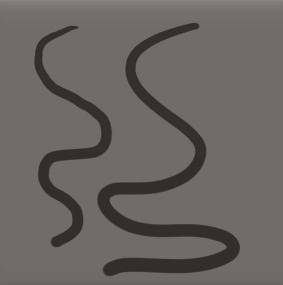

New Member rodriguesbjerre Posted March 5, 2018 New Member Share Posted March 5, 2018 Hey For some reasons my lines are pretty jagged whenever i paint them from further away, resulting in a less-than-desired effect. I've drawn 2 strokes with the exact same brush, only difference being that i drew one up close to the model, and one further away. Anyway to prevent this? I really like the program, but this is pretty deal-breaking tbh. Quote Link to comment Share on other sites More sharing options...
Reputable Contributor AbnRanger Posted March 5, 2018 Reputable Contributor Share Posted March 5, 2018 Probably either low resolution maps or very, very small UV island. covering that part of the model. Quote Link to comment Share on other sites More sharing options...
Reputable Contributor digman Posted March 5, 2018 Reputable Contributor Share Posted March 5, 2018 (edited) Steady Stroke or in other words Lazy Mouse. Upper left hand corner of the UI. Default is 15 but you can change it. Lower less effect, higher more effect of the lazy mouse. Picture shows, stroke on the left without lazy mouse, close to the model. Stroke on the right with lazy mouse zoomed out from the model to make the stroke. The above works if you have enough texture resolution or the uv island is covering enough texel density space in the uv set as AbnRanger said.. Edited March 5, 2018 by digman Quote Link to comment Share on other sites More sharing options...
New Member rodriguesbjerre Posted March 5, 2018 Author New Member Share Posted March 5, 2018 Steady stroke helped. The model had the same problems at 2k and even at 4k, so not sure if that was it. Quote Link to comment Share on other sites More sharing options...
Reputable Contributor AbnRanger Posted March 5, 2018 Reputable Contributor Share Posted March 5, 2018 Nevermind my previous post. I didn't read it carefully enough. I just saw the pixelation. Did a test and it seems painting from a distance probably magnifies the movement in your cursor. Why would you paint way off from the camera, though? I had to zoom pretty far away to replicate the results you get. Even at a medium distance, it's not any different that I expected. Turning Steady Stroke on, rectifies that, as Digman just point out. Quote Link to comment Share on other sites More sharing options...
