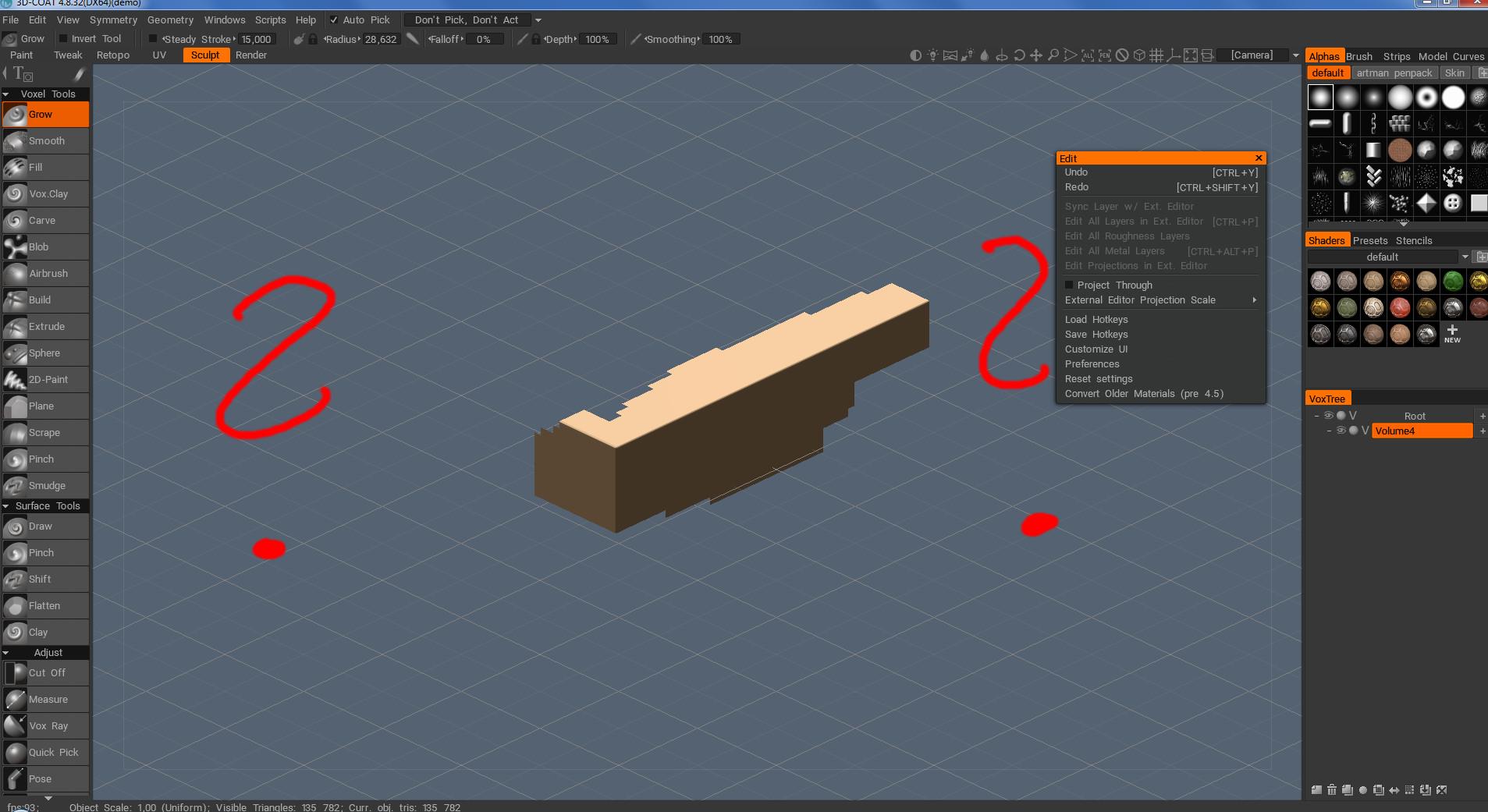

Here's a new one on me, a .3B file exported as OBJ got changed:
Any ideas besides creating it in a polygon modeler?
