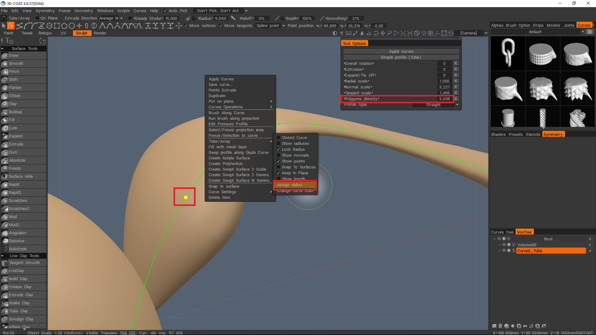

Oleg_Shapo Posted April 5, 2019 Report Share Posted April 5, 2019 12 hours ago, animk said: It doesn't do anything by changing the point connection type. Is it possible to add a radial scale control for selected point to future build? I assign the radius of each point and have no difficulty with this. Try changing the Polygons Density setting. Link to comment Share on other sites More sharing options...

Advanced Member animk Posted April 5, 2019 Advanced Member Report Share Posted April 5, 2019 38 minutes ago, Oleg_Shapo said: I assign the radius of each point and have no difficulty with this. Try changing the Polygons Density setting. Thanks a lot, that solved my problem, I can also assign radius to selected points by unchecking the "lock radius" 1 Link to comment Share on other sites More sharing options...
