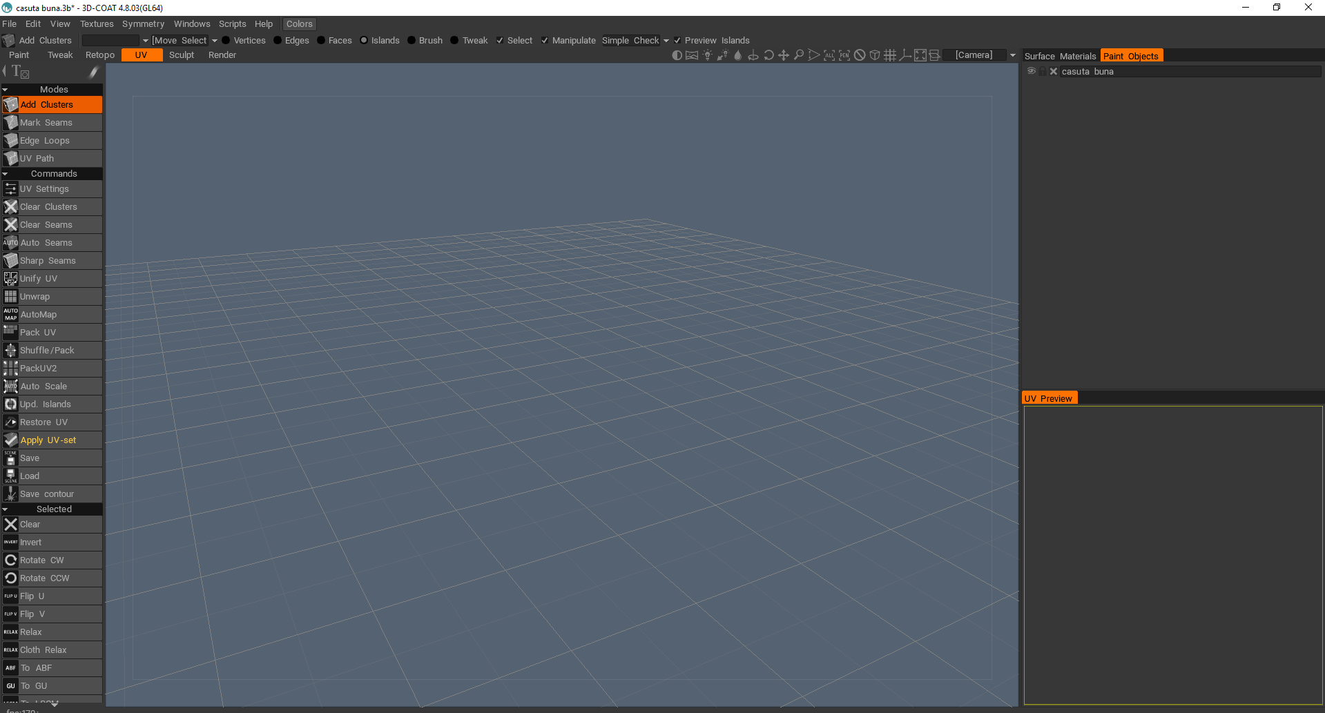

This is what appears when I enter in UV tab... nothing. I picked up smart materials and paint over the mesh... I am really noob here at UV can you send a tutorial video or something ? I will really appreciate that.

Another thought. If you're just in surface mode and didn't have a UV map, then it's just coloring the vertices (points) on the mesh, not actually painting on an image. In that case having more points will give you more detail. So areas that don't look good might have a low poly count. You could tell by hitting W to see the wireframe.
