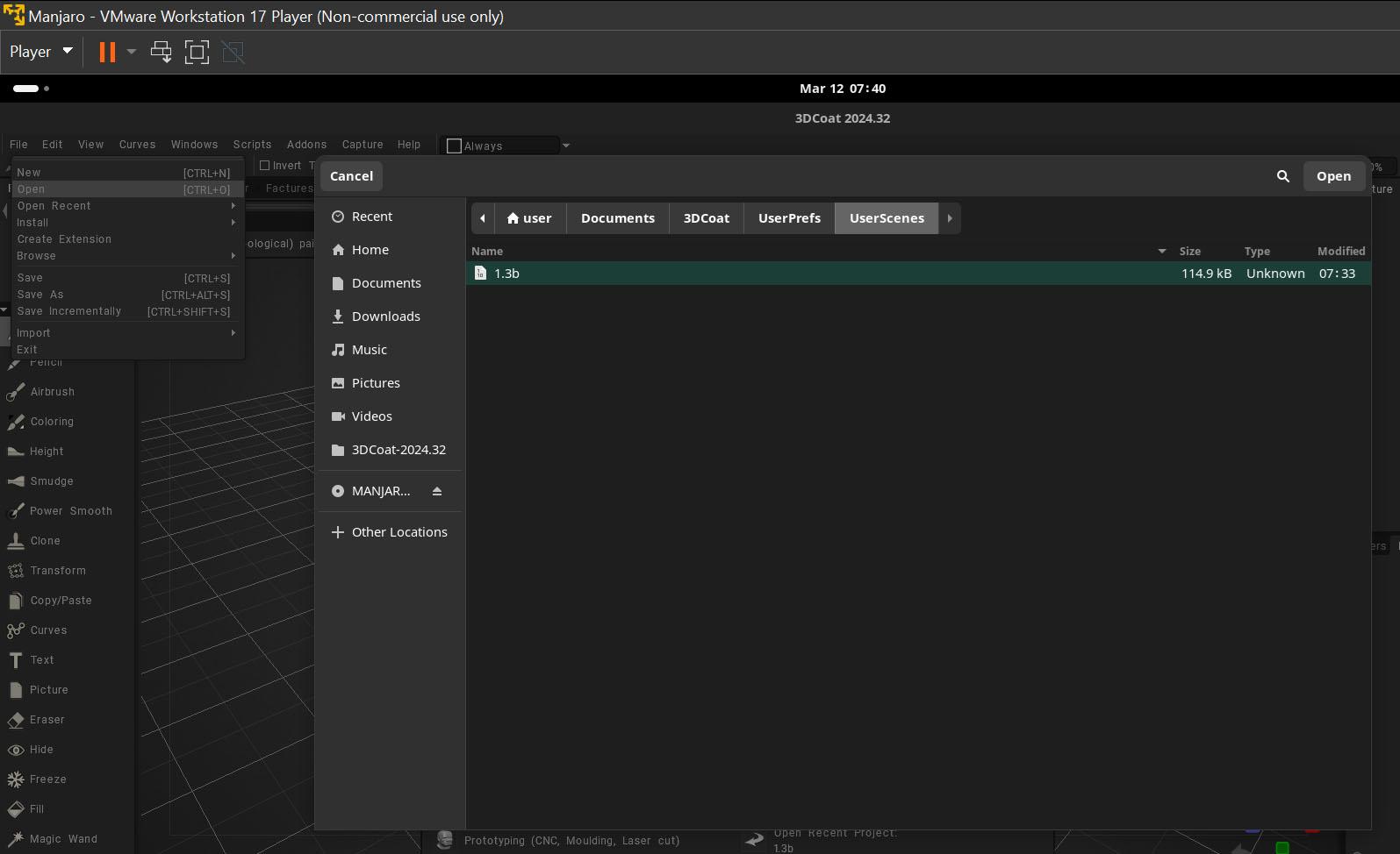

I have attached a screenshot with a file dialog under Linux Manjaro. Note that the file dialog has a modern theme because 3DCoat uses GTK3. In GTK2, the file dialogs have a classic Linux style without a theme.
The culprit of the file dialogs problem is revealed. Different build systems generate code that works differently, which is terrible for developers. Next, I will resolve issues known under PopOS.
