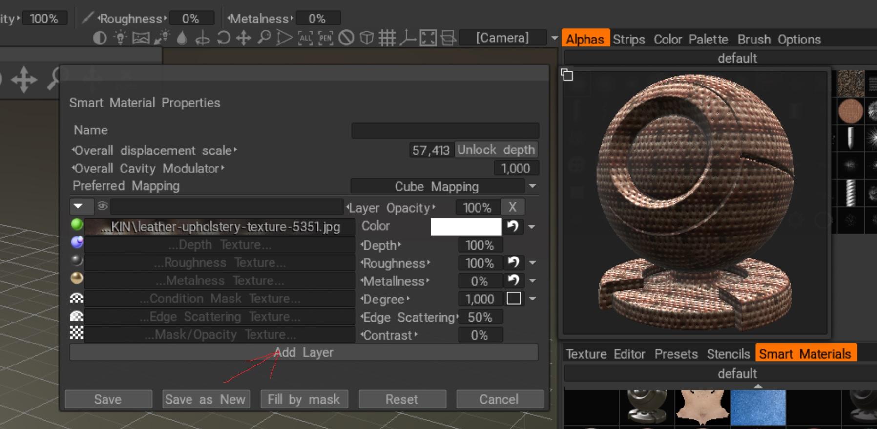

Member wlokaz Posted November 6, 2019 Member Share Posted November 6, 2019 (edited) Hi. I noticed a problem creating new material. When I want to add a new layer of material, I don't see any option buttons. I can't create material from multiple layers. Is this just my problem. Did I not read something after the changes? Please help. Best regards. Edited November 6, 2019 by wlokaz Link to comment https://3dcoat.com/forum/index.php?/topic/23667-3dcoat-49-beta-testing-thread/page/24/#findComment-163595 Share on other sites More sharing options...
Carlosan Posted November 6, 2019 Share Posted November 6, 2019 @wlokaz Bug Confirmed: no add layer On some old smart materials: Preview Option > Select from camera make Preview disappear. //edited Link to comment https://3dcoat.com/forum/index.php?/topic/23667-3dcoat-49-beta-testing-thread/page/24/#findComment-163596 Share on other sites More sharing options...
Member wlokaz Posted November 6, 2019 Member Share Posted November 6, 2019 19 minutes ago, Carlosan said: @wlokaz Bug Confirmed W przypadku niektórych starych inteligentnych materiałów: Opcja podglądu> Wybierz z aparatu, aby Podgląd zniknął. Maybe I did not express myself well. The point is that there is no "Add layer" when creating content. In 4.9.05 it is - as in the attached picture. I don't see another "Add layer" option in 4.9.07 1 Link to comment https://3dcoat.com/forum/index.php?/topic/23667-3dcoat-49-beta-testing-thread/page/24/#findComment-163597 Share on other sites More sharing options...
Reputable Contributor Silas Merlin Posted November 6, 2019 Reputable Contributor Share Posted November 6, 2019 No "add layer" here either, whether it is on an existing smart material or a newly created one 1 Link to comment https://3dcoat.com/forum/index.php?/topic/23667-3dcoat-49-beta-testing-thread/page/24/#findComment-163598 Share on other sites More sharing options...
