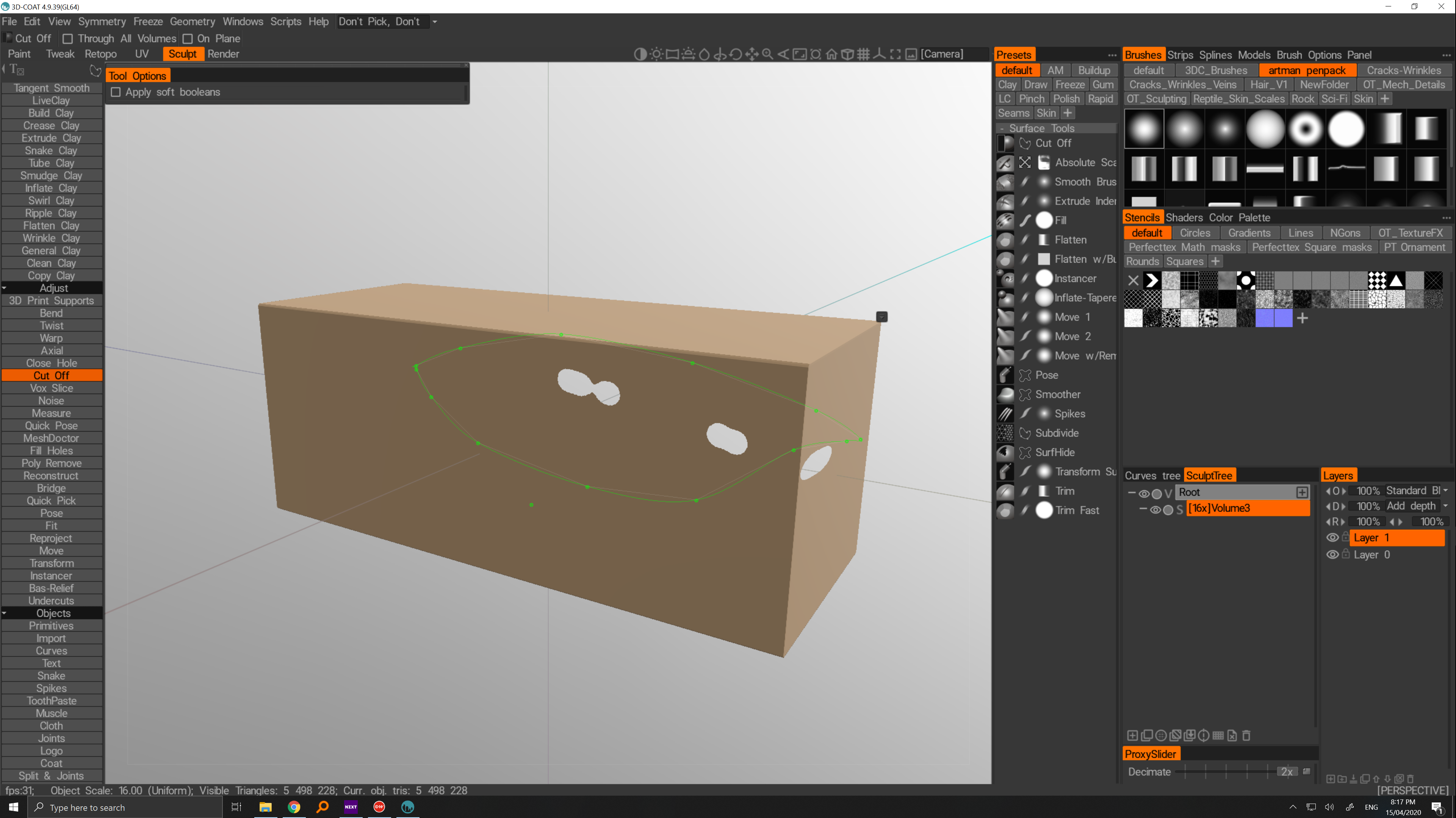

Member Southern_Cross Posted April 15, 2020 Author Member Share Posted April 15, 2020 On 4/6/2020 at 10:02 PM, AbnRanger said: I've had way more than 43million polys in a scene, and it not slow the system down. That's with an AMD Ryzen 2700X and ThreadRipper 1950X (64GB RAM). I wonder if the INTEGRATED GRAPHICS on the 9900K might be the source of the problem. You might check with Andrew about this (support@3DCoat.com) No - As I have upgraded to a R9 3950 and now I'm having issues with 6 Million Tris - Surface mode with a CUT I love this Software, I know that the Devs are working hard. But this is disappointing I really thought my i9-9900k was a bottle neck, but it's not. I'm using Benchmarking software to make sure everything is running fine on my PC and it is. I can now push 20 Million Tris on Voxel mode, but using the tools is hit or miss. Quote Link to comment https://3dcoat.com/forum/index.php?/topic/24402-amd-vs-intel-power-users-q/#findComment-166443 Share on other sites More sharing options...

Member Southern_Cross Posted April 15, 2020 Author Member Share Posted April 15, 2020 Open GL didn't crash or stall The results were not what I would of expected - pics included. Thanks for your reply Quote Link to comment https://3dcoat.com/forum/index.php?/topic/24402-amd-vs-intel-power-users-q/#findComment-166448 Share on other sites More sharing options...
Carlosan Posted April 15, 2020 Share Posted April 15, 2020 Bug confirmed and reported. Thx for point it up. Avoid using Cutoff with Closed Spline rounding all the mesh. Works fine from camera projection on 2D planes Quote Link to comment https://3dcoat.com/forum/index.php?/topic/24402-amd-vs-intel-power-users-q/#findComment-166451 Share on other sites More sharing options...
