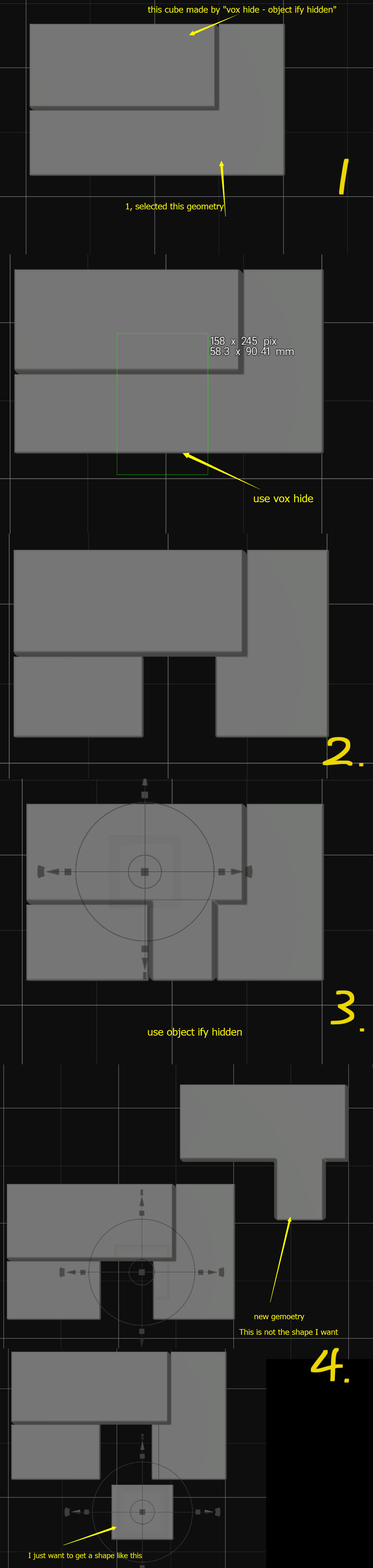

Hello everyone, I am a newie using 3d coat , I encountered two questions when using vox hide
1, How to control the bevel of new objects made by "vox hide-object-ify hidden"
2, a Problems encountered when using object-ify hidden,hope to get help, Thanks!

hi guys, thanks for reply!
In the second question, is my operation wrong? How can I use "object-ify" hidden correctly?
Hi
If you need to work with the modified mesh -not the original- remember to use first the command Delete Hidden.
Hope it help
