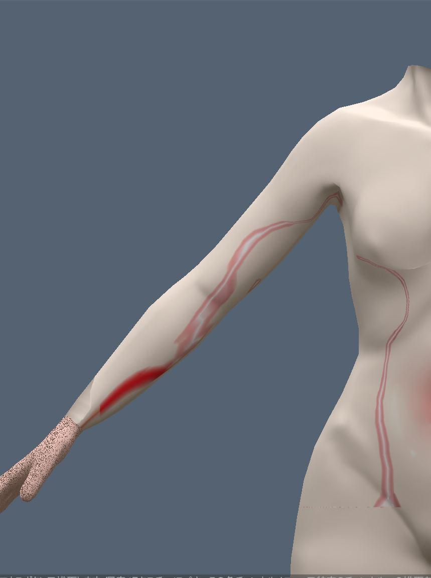

Thank you for your reply!
I try not to overlap each material.
Is it due to the mask function of Photoshop?
This is what happened when I used a lot of masks.
Share this post
Link to post
Yes, Photoshop mask are not compatible with 3DC.

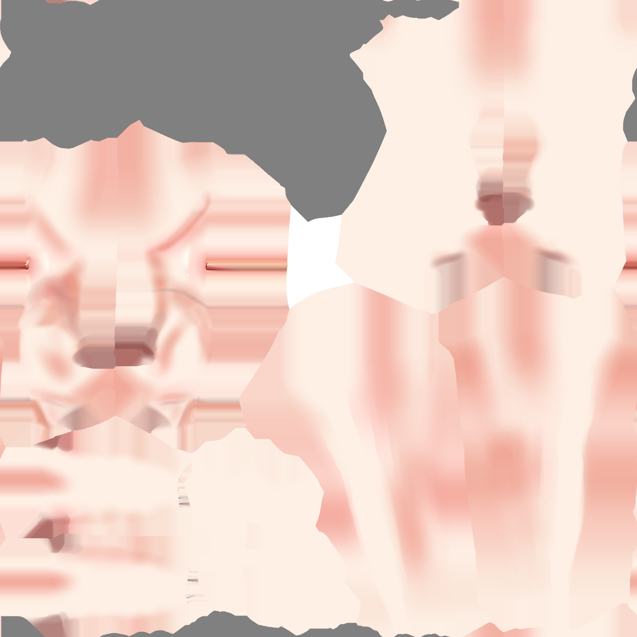

I painted it without a mask.
4.JPG.ec8db0aceb1e60598ad0bb95ba58d3f9.JPG3.thumb.JPG.361a2b242b8b0501eba102fa9077e8c9.JPG
However
I got an error.
There was a place painted in gray.
The number of layers that have not been created is increasing.

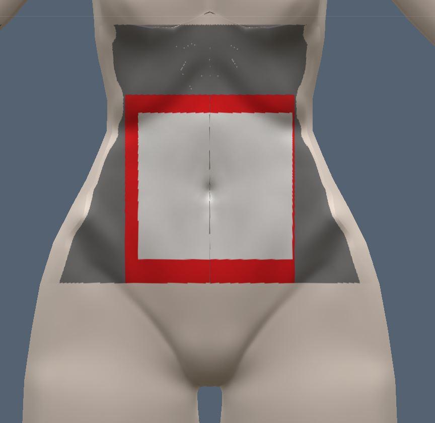

It was 4.9.37.
updated.
The version has been changed to 4.9.67.
I tried again.
4.thumb.JPG.ec55f2bce4d843d2a1ca640860ad6234.JPG3.JPG.ef7af0c2c99b25457b91e83a9c0fc67a.JPG
The painting was successful.
But,
The back side has disappeared.
Share this post
Link to post
Avoid to delete Layer0
Is used for internal calculations, or to create transparency.
