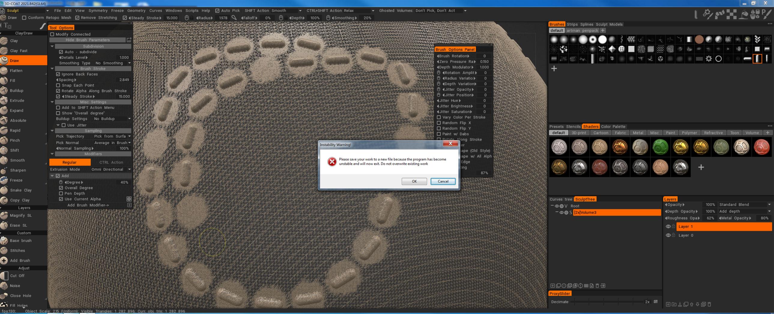

Test in 2021 (B40)
This is a curve option that appears in the Modeling Room.
I only thought about the RMB menu, but I forgot that there was also something like this at the top....
Anyway
It seems to be a function that fills the inside of the curve area with a quad or triangle face.
Doesn't work.
In the case of Triangle, it crashes.
Do i need specific conditions? Or is it a bug?
