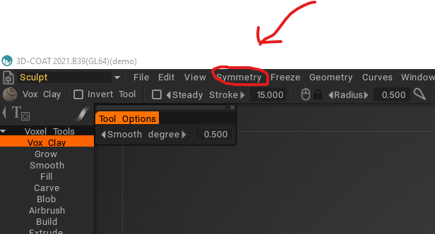

New Member SMSDIGITAL-UK Posted May 10, 2021 New Member Share Posted May 10, 2021 Hi all - RE: BUG HUNTING Nothing major but the Symmetry Tab is not automatically visible on the tool bar and has to be toggled on via the preset panel. Also I encountered a bug with the DIAMETER Slider not working. The Gizmo and text inputs work but the mouse slider action doesn't I hope this is of some use. Keep up the great work! Link to comment Share on other sites More sharing options...
