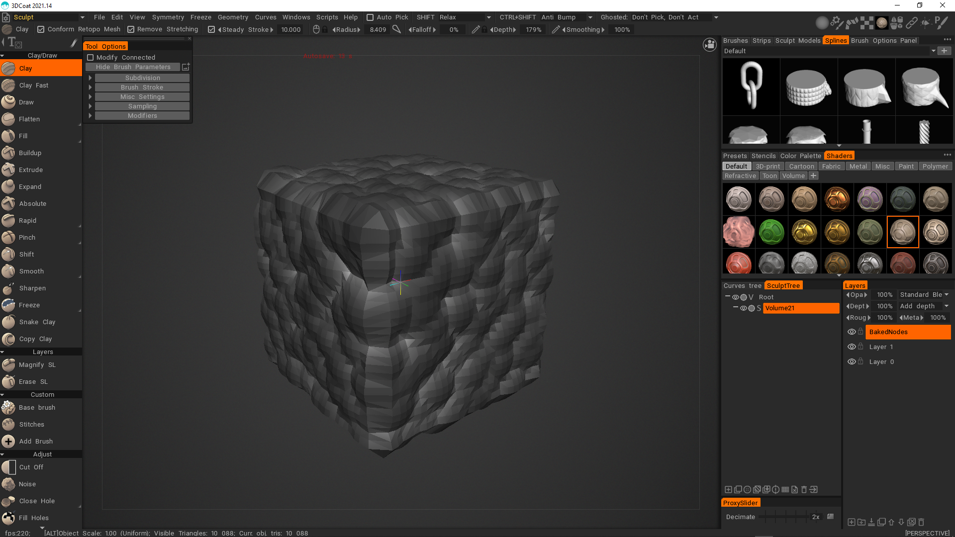

1 hour ago, Andrew Shpagin said:
The reason is that you sculpted something into the "BakedNodes" layer. Nodes baking overwrites that layer, so your layer content vanished. Try to rename the BakedNodes layer before baking.
It's happening even with the default sphere.
I'll do some testing, but I also tried deleting the default shere in voxel sculpting and creating a new sphere primitive in which case it worked...but I had the same problem with cube and some other primitive shapes.
Node setup.
No sculpting done.
It worked this time...but it's not working every time????  Very strange...I'll see if I can pinpoint the issue.  Maybe you can try a few times to see if works consistently.
