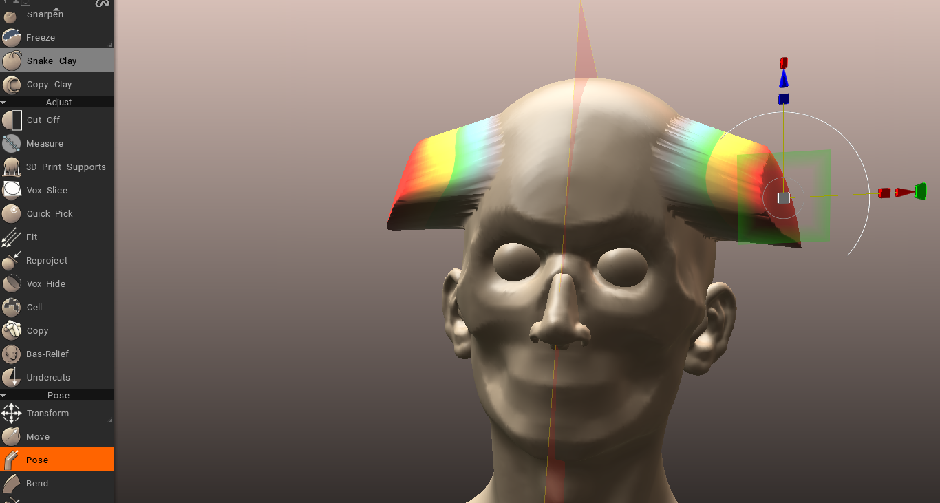

the following does not truly bother me but I find it does not really make sense :
Why are the tool options for the muscle tool on the top bar rather than in the options panel like for (most?) other tools ?
The Bar profile looks quite interesting, as for the alpha profile, I think it is brilliant and opens new possibilities.
It is still so very frustrating that there is no way to prevent the muscle tool from snapping to a distant object.
Radius pressure still has no effect on muscle tool.
What is "points to polygon" doing there in the sculpt room ? (look at end of video)  It would make sense if it were a "temporary" retopo layer, with options in the tool options panel to import it as surface, or as voxels into the current layer with thickness, or as cloth,  and a button to delete the temporary retopo layer.

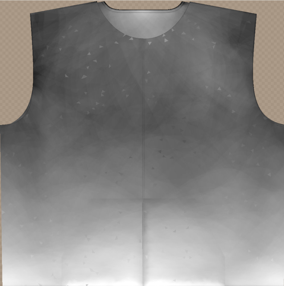

Here just crash at import model for per pixel painting with keeping uv, model from marvelous designer it looks heavy for 3dcoat to bake AO and also it produce artifacts on some parts.
And no crash logs in Documents\3DCoat-2021
Hoodie Front pocket zipper.7z crash
Hoodie Front pocket zipper-fix-no crash for AO.7z for AO
Edited by sprayer
