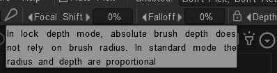

11 hours ago, tcwik said:
WHY, oh, Why was this built that way? Depth change the size of the Brush ?!
@tcwik It is not a bug
Check if you have the padlock icon pressed, if yes turn it off
all types tried , cylinder sphere brush still does this
This is definitely a bug, not a feature. Depth cannot change the size of the brush, and padlock doesn't help here.
