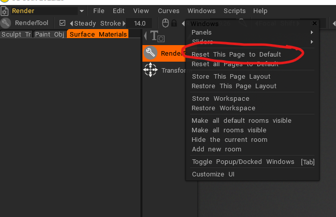

22 hours ago, alexn007 said:
Hi Mihu83, not sure if this helps address the issue, but there is a "Reset This Page to Default" option. I may have misunderstood your post, so I apologize if I did.
Nope, this setting will reset any custom Render Room layout(windows arrangement). What I've meant with Reset Settings, is bringing lights, fog, DOF, etc. to defaults.

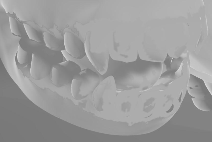

When exporting a sculpt object, face normals seems to be always broken if no decimation is applied:
1773954433_Capturedcran2022-05-16200159.thumb.jpg.42728bf1fa234c57bf2d6c2f94a65d4b.jpg
https://www.dropbox.com/s/qm1p7yupdd6duig/Galek_hand_teeth_A002.3b?dl=0
(need to recalculate outside, set from face in edit mode in Blender for example.)
Edited by liok
even if decimated it is true
