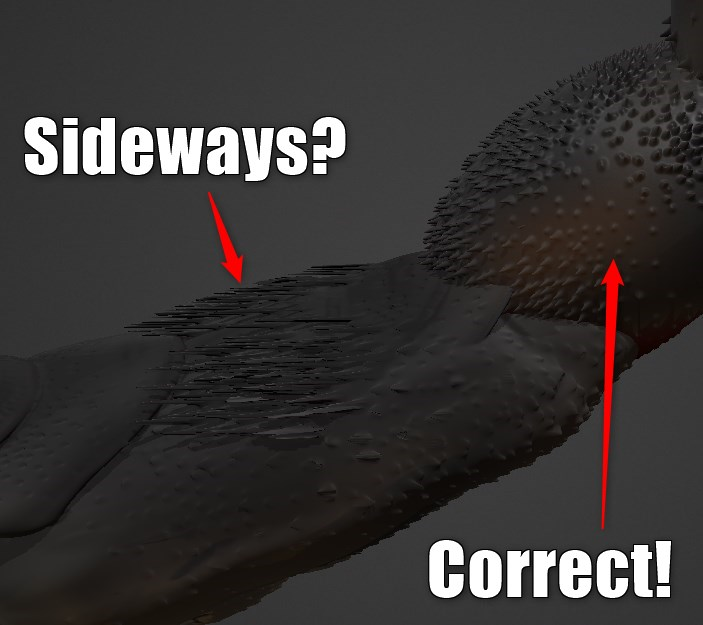

I'm having an issue with 2021.70 where when I paint depth onto the body or legs of this model it goes sideways instead of out from the mesh.  You can see that one part worked fine, but the other looks like it has fur on it going sideways.  It's not a brush rotation or an axis change, as I've tried changing those and the problem still exists.  Has anyone else had this issue?

Hi
To convert a sculpt layer from NonUniform to Uniform, right click on the layer in the SculptTree and select 'To global space'
I hope that helps.
