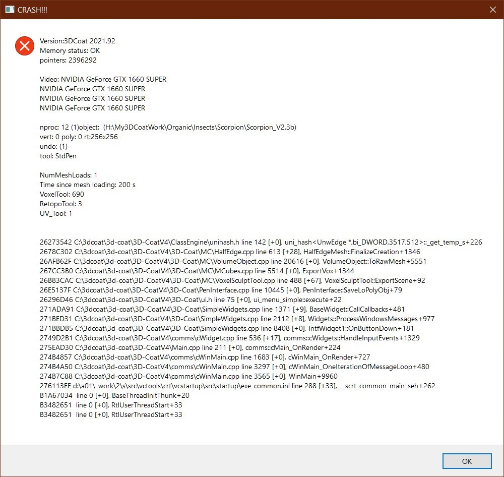

Advanced Member alvordr Posted January 22 Author Advanced Member Report Share Posted January 22 (edited) I'm using 2021.92. I tried doing the reset settings option in the Settings area of 3D Coat, but it quickly crashed when I tried to see if my problem was fixed by clicking on Export Objects and Textures. The error it gave me was this: The steps I'm taking are to Select the Paint Room and Press File at the menu at the top and then press Export Objects and Textures. I then select the path, name for the file, file type and then it starts exporting and asks for how much poly reduction I want. That's it. I don't know what a video is going to tell you here. I'm uninstalling 2021.92 and installing 2021.70, since that's supposed to be a stable release. Although, that was where I started in this process. Edited January 22 by alvordr Quote Link to comment Share on other sites More sharing options...
