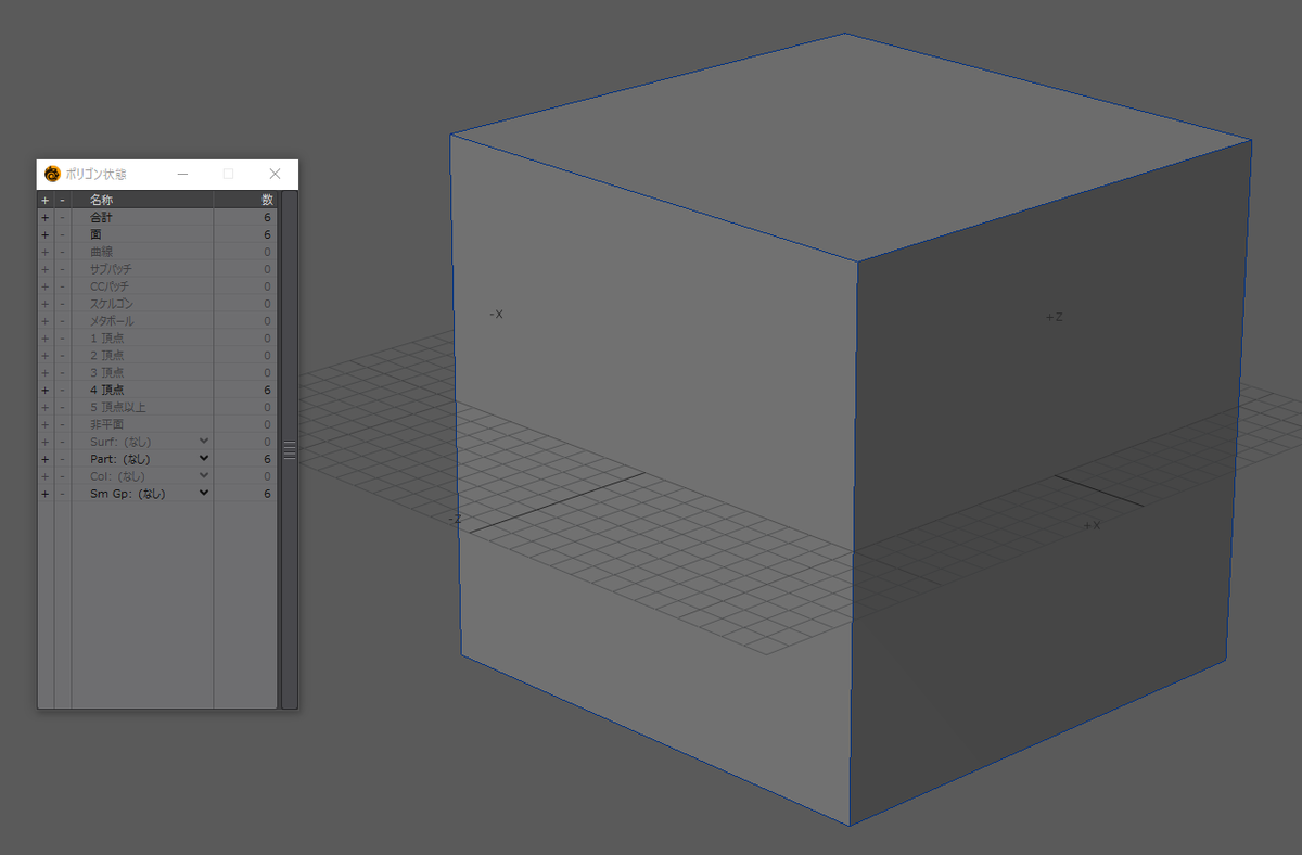

Create a primitive cube in Lightwave. The number of polygons is "6" as a matter of course.

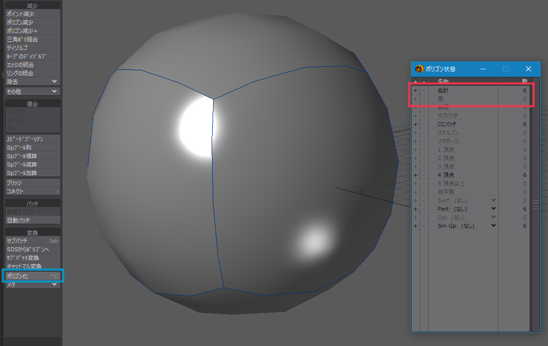

The cube is subdivided by applying CC, but the number of polygons that can be counted is still "6". (red frame)

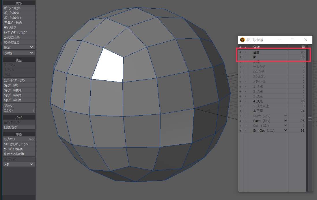

Then, press the "Polygonize" button (blue frame) to finalize the subdivision.
Then the division is fixed with CC applied and the polygon count of this object is counted. In this case, we used CC division level 2. The polygon count is "96".
Do this for each CC division level and check the polygon count according to the level.
And I made an animated gif to make the results easier to understand.
The polygon count matches the number in the 3DCOAT panel pasted at the beginning of this article.
Therefore, that number seems to be correct for the number of polygons subdivided by each division level of CC. Simply remember that it is level 1, 2, 3~ from the top.
