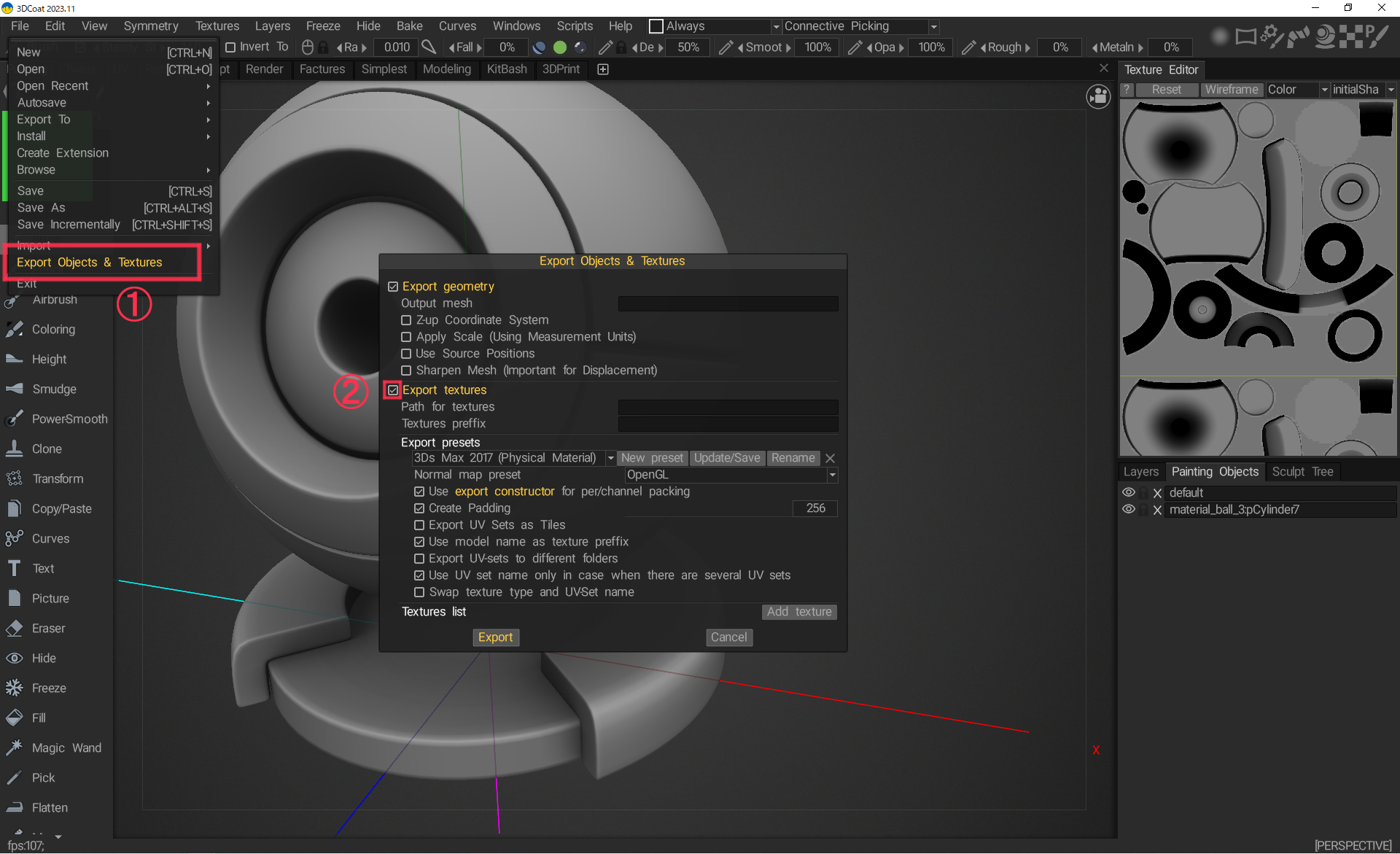

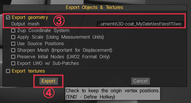

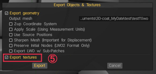

New Member lunarbor Posted April 2, 2023 New Member Share Posted April 2, 2023 OS:windows10 home Software version:2022.60 - 2023.11 "Export Objects & Textures" is out of order. 1,Select "Export Objects & Textures" in "Painting Room". 2,Uncheck "Export Textures". 3,Specify the save location of the object in "Output mesh" of "Export geometry". (This will close the "Export Textures" option.) 4.Click "Export" to export. 5,Select "Export Objects & Textures" again to bring up the panel, the "Export Textures" option is closed. Checking the checkbox does not open any options. The option cannot be set even if it is checked, but it can be exported. However, existing files will be overwritten. When you open "Export Objects & Textures" again you will see the options. The same thing happens with "Export geometry". I have a video on my Twitter. https://twitter.com/lunarbor/status/1642154523673399297 1 1 Quote Link to comment https://3dcoat.com/forum/index.php?/topic/27881-paint-room-bug-hunt-report-it-here/#findComment-187707 Share on other sites More sharing options...

Carlosan Posted April 2, 2023 Author Share Posted April 2, 2023 @lunarbor 3DCoat-2023-12 - The export dialog has been corrected; there was a problem where the UI would not refresh depending on the Export Geometry/Textures checkboxes. 1 Quote Link to comment https://3dcoat.com/forum/index.php?/topic/27881-paint-room-bug-hunt-report-it-here/#findComment-187714 Share on other sites More sharing options...
