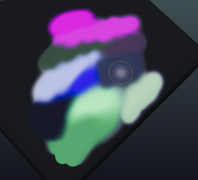

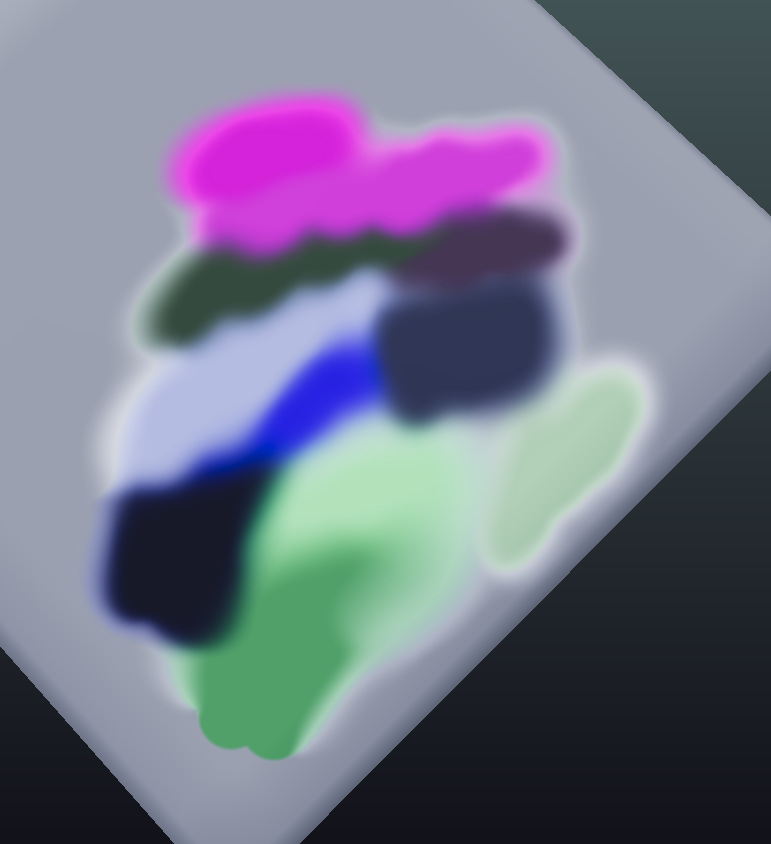

Member ichbinliese Posted March 5, 2024 Member Share Posted March 5, 2024 47 minutes ago, Elemeno said: its not a bug .. the color picker chooses between albedo and real world colors ... for example if ou see something on your model and think i like that shade the first "V" shows that color ... the v again shows the actual color without lighting or glossy etc... grey shows up due to the bake layer below ... if youre landing on an area without color it will be greyed out as it has no information to show Okay, so it's not a bug. However, in the process of painting and choosing colors very fast (brush-pick- brush-pick-etc.) I constantly run into the problem of sampling grey, just because I sometimes press V twice very short after each other, beacuse I realise I did not have the exact right color. Is there a workaround for me? Quote Link to comment https://3dcoat.com/forum/index.php?/topic/27881-paint-room-bug-hunt-report-it-here/page/5/#findComment-193774 Share on other sites More sharing options...

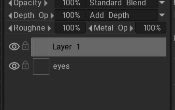

Advanced Member yoohasz Posted March 6, 2024 Advanced Member Share Posted March 6, 2024 (edited) I can't open a folder -(group layer) with a mask. Video: EDIT: Okay, so if I click the group icon then it expands, but clicking the arrow does nothing. So I guess it's just confusing to have an arrow that's inactive, but when the GROUP doesn't have a mask it's active, the arrow really expands the group. Edited March 6, 2024 by yoohasz 1 Quote Link to comment https://3dcoat.com/forum/index.php?/topic/27881-paint-room-bug-hunt-report-it-here/page/5/#findComment-193777 Share on other sites More sharing options...

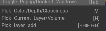

Advanced Member Vexod14 Posted July 29, 2024 Advanced Member Share Posted July 29, 2024 Hello there ! In the latest stable build of 3DCoat 2024, I face this curious issue : Is this known ? Is there a fix I should apply on my end ? Thanks for your help ! 1 1 Quote Link to comment https://3dcoat.com/forum/index.php?/topic/27881-paint-room-bug-hunt-report-it-here/page/5/#findComment-195882 Share on other sites More sharing options...
Advanced Member Vexod14 Posted July 29, 2024 Advanced Member Share Posted July 29, 2024 Also another bug : the picking tool seems to evaluate the cursor color, or pick at wrong depth in the ZPass of the renderer. I regularly have to pick again because the picked color is grey and not the one I see under the picking tool, it's a really strange bug Quote Link to comment https://3dcoat.com/forum/index.php?/topic/27881-paint-room-bug-hunt-report-it-here/page/5/#findComment-195883 Share on other sites More sharing options...
Carlosan Posted July 29, 2024 Author Share Posted July 29, 2024 Is this info in the popup tip related ? Sampler Tool. Extract the Color, Glossiness, and Depth from the surface of an object. Use the V hotkey to select the primary color and depth outside this tool. You can change picking preferences using this tool. Use H to select the top layer. Pay attention, if you will tap the picker hotkey twice over the same color (like the layer color) it will pick the color just from the screen. In this way you may easily choose the right color, from the object or from the screen. Quote Link to comment https://3dcoat.com/forum/index.php?/topic/27881-paint-room-bug-hunt-report-it-here/page/5/#findComment-195886 Share on other sites More sharing options...
Advanced Member Vexod14 Posted July 29, 2024 Advanced Member Share Posted July 29, 2024 I guess the issue comes from that "twice picking". Is there a way to prevent this option from triggering ? It's disabled in Tool's options pannel, but still fires it. 1 Quote Link to comment https://3dcoat.com/forum/index.php?/topic/27881-paint-room-bug-hunt-report-it-here/page/5/#findComment-195887 Share on other sites More sharing options...

Member tiburbage Posted July 29, 2024 Member Share Posted July 29, 2024 13 hours ago, Vexod14 said: Hello there ! In the latest stable build of 3DCoat 2024, I face this curious issue : Is this known ? Is there a fix I should apply on my end ? Thanks for your help ! I would also like my choice of color picker to be honored, either by way of a Preference, or to simply have it saved as a workspace setting. 1 Quote Link to comment https://3dcoat.com/forum/index.php?/topic/27881-paint-room-bug-hunt-report-it-here/page/5/#findComment-195907 Share on other sites More sharing options...
Member tiburbage Posted July 29, 2024 Member Share Posted July 29, 2024 11 hours ago, Carlosan said: Is this info in the popup tip related ? Sampler Tool. Extract the Color, Glossiness, and Depth from the surface of an object. Use the V hotkey to select the primary color and depth outside this tool. You can change picking preferences using this tool. Use H to select the top layer. Pay attention, if you will tap the picker hotkey twice over the same color (like the layer color) it will pick the color just from the screen. In this way you may easily choose the right color, from the object or from the screen. The one question in my mind with the "V" key "mode" toggle (i.e. alternate taps) which it would be good to clarify is whether the toggle is between "Screen" and underlying texture value, or "Current Layer" vs "All Layers". Quote Link to comment https://3dcoat.com/forum/index.php?/topic/27881-paint-room-bug-hunt-report-it-here/page/5/#findComment-195908 Share on other sites More sharing options...
Member tiburbage Posted July 29, 2024 Member Share Posted July 29, 2024 This post was recognized by Carlosan! tiburbage was awarded the badge 'Great Content' and 1 points. Just throwing out a tip: if wanting to sample Albedo color off the model, even with "Pick a color from the screen" on,use View > Flat Shade because with Smooth Shaded, it will pick up the shaded value -- in this case, not what you want. 1 Quote Link to comment https://3dcoat.com/forum/index.php?/topic/27881-paint-room-bug-hunt-report-it-here/page/5/#findComment-195909 Share on other sites More sharing options...
