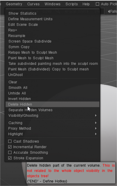

0 Carlosan Posted March 18, 2023 Report Share Posted March 18, 2023 On Sculpt room you can try this command 1 Quote Link to comment Share on other sites More sharing options...
1 Member Jakejazz Posted March 18, 2023 Author Member Report Share Posted March 18, 2023 Thank you Carlosan. Hard to know whether this has removed unwanted points as the some points continue to refuse to be moved by the brush. I went back a few stages and created a mesh without the issues. I think that the issue may have been caused be used the subdivide tool. Thanks again. 1 Quote Link to comment Share on other sites More sharing options...
