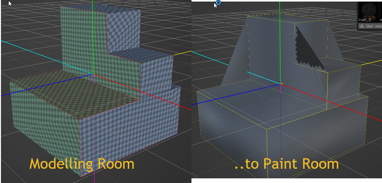

Advanced Member Grimmy Posted March 30, 2023 Advanced Member Share Posted March 30, 2023 (edited) I built a model in the modelling room, UV'd it and now I want to paint it. But how do I send it to the paint room? Seems like this should be a fairly obvious button somewhere but I can't find it. Thanks Edited March 30, 2023 by Grimmy Quote Link to comment Share on other sites More sharing options...

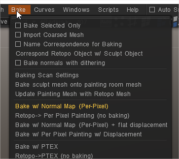

0 Carlosan Posted March 30, 2023 Share Posted March 30, 2023 Modeling/Retopo room are similars. If the model was previously on Paint Room, in the Modeling/Retopo Room there is an option to UPDATE PAINT MESH w/ RETOPO MESH. It's in the BAKE Menu. Give that a try and see if it works properly for you. Quote Link to comment Share on other sites More sharing options...
0 Advanced Member Grimmy Posted March 30, 2023 Author Advanced Member Share Posted March 30, 2023 Thanks. I tried that but the model gets all messed up when I see it in the paint room. As you can see this is just a very simple test model. Quote Link to comment Share on other sites More sharing options...
0 Carlosan Posted March 30, 2023 Share Posted March 30, 2023 When bake, remember to avoid nGons using this option Quote Link to comment Share on other sites More sharing options...
