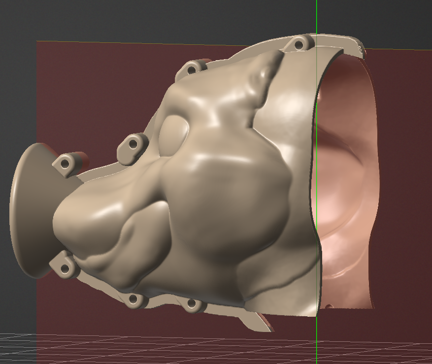

Member celer Posted July 2, 2023 Member Share Posted July 2, 2023 (edited) So I'm expecting to generate a mold for casting, I'm getting closer to getting what I want which should look like this: But I'm having some challenges, when try to do an extrusion for the seam: def extrude(target=coat.SceneElement,amount=int): coat.Scene.sculptRoot().unselectAll() target.select() print("Extruding "+target.name()+" by "+str(amount)) def setExtrusion(): coat.ui.setSliderValue("$ExtrudeParams::Extrusion",amount) coat.ui.cmd("$DialogButton#1") coat.ui.cmd("$ExtrudeVO",setExtrusion) coat.ui.wait("$ExtrudeVO",30) And then do an intersection (is the coat.ui.wait(...) even needed, I have no idea. def intSeam(target=coat.SceneElement,width=int): bbox=target.Volume().calcWorldSpaceAABB() center=bbox.GetCenter() size=bbox.GetSize() size.x=width # Shift this up by the seam size amount center.z=center.z-15 print("Intersecting seam "+target.name()+" "+str(width)) sbox=coat.box(center,size) sbox.intersect(target.Volume()) like so: mold_seam=pmold.duplicate() mold_seam.rename("mold_seam") extrude(mold_seam,15) # This fails sometimes intSeam(mold_seam,10) It just doesn't do the intersection sometimes, sometimes running the script 10 times, 9/10 times it will fail, and won't perform the intersection, sometimes restarting 3D Coat will cause it to work Sometimes it works and I can't get it to fail, it's very inconsistent. I either don't understand something, or there is a bug. I'm so excited about python scripting 3D Coat but it's a bit buggy. Previously I was getting very weird results with extrusions, which I posted about in another forum thread, but a restart seems to have fixed that. I either think there is a race condition or a cache invalidation problem - it feels like a bit of both, restarting it fixes is, so seems like a cache validation problem, but then also it feels like a bit of a race condition - is the extrusion finishing before the intersection is complete? negative_mold_test.3b head_mold.py Edited July 2, 2023 by celer to clarify how it fails Quote Link to comment Share on other sites More sharing options...
