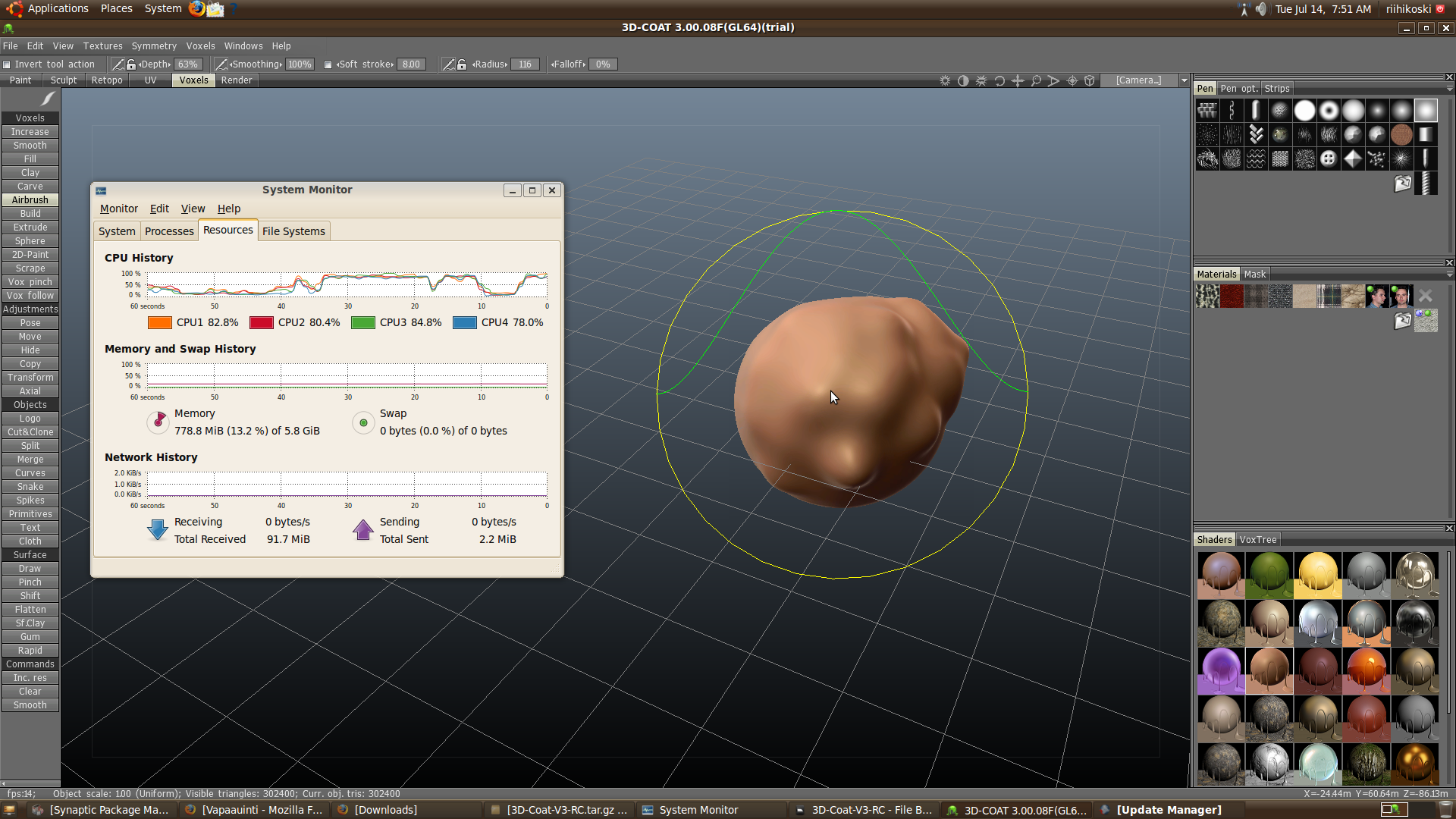

Applink Developer haikalle Posted July 14, 2009 Applink Developer Share Posted July 14, 2009 Here is my cpu load when using 3d-coat linux. It seems that bigger your brush is more it will use cpu load which seems to work quite well. With small brush I'm only getting 30% load to my 4 core cpu but when I increase brush size I'm able to get 100% to all cores. There still seems to be something odd still. 3d-coat crashed after 5 min and all my desktop icons dissapeard. Also my wacom table works but it can't control brush radius. Link to comment https://3dcoat.com/forum/index.php?/topic/2876-30008-beta/page/17/#findComment-23730 Share on other sites More sharing options...
Andrew Shpagin Posted July 14, 2009 Author Share Posted July 14, 2009 I have a question to Andrew:When sculpting in Voxel mode 3DC uses not all CPU cores consistant. At voxel level 3 the first core of my Core2Quad processor is at 100% load. Other tree cores at around 10 to 20% load or off. FPS slowing down rapidly when first core is at 100%. Is it possible to optimize the CPU usage for sculpting? Maybe things will speed up... ... Multicore Optimization is enabled in preferences. I'm running WINXP 64, Geforce 8800GTS and 8GB RAM. BTW: great new release!!! greez, Rene In your case most of load is put on GPU, not CPU. And it works faster then loading all cores of CPU. If you will turn off CUDA, CPU-s will be loaded sometimes up to 80-90% Possibly I will find some way to load all - GPU & CPU. Link to comment https://3dcoat.com/forum/index.php?/topic/2876-30008-beta/page/17/#findComment-23732 Share on other sites More sharing options...
Applink Developer haikalle Posted July 14, 2009 Applink Developer Share Posted July 14, 2009 That makes sense. Hope you can find something. Link to comment https://3dcoat.com/forum/index.php?/topic/2876-30008-beta/page/17/#findComment-23734 Share on other sites More sharing options...
Advanced Member cuffins Posted July 14, 2009 Advanced Member Share Posted July 14, 2009 In your case most of load is put on GPU, not CPU.And it works faster then loading all cores of CPU. If you will turn off CUDA, CPU-s will be loaded sometimes up to 80-90% Possibly I will find some way to load all - GPU & CPU. Thank's Andrew! Will be great if you find a way to heat up all chips to the limit... Link to comment https://3dcoat.com/forum/index.php?/topic/2876-30008-beta/page/17/#findComment-23747 Share on other sites More sharing options...

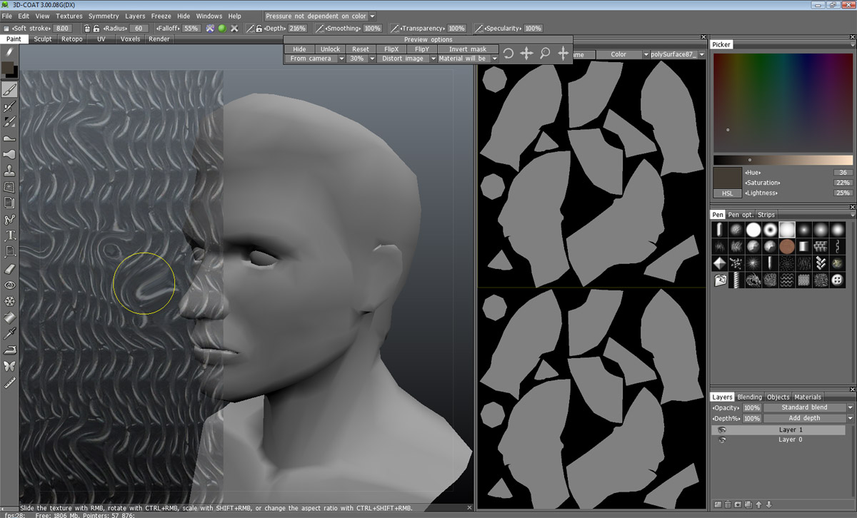

Andrew Shpagin Posted July 14, 2009 Author Share Posted July 14, 2009 Material Distort displays fine in Voxel room but in Paint room with object for Per Pixel painting as soon as you try to distort the material with LMB the image flicks to the far left of the screen then back again once you've released button. It could be good if you will show short video or screenshot how it looks. Link to comment https://3dcoat.com/forum/index.php?/topic/2876-30008-beta/page/17/#findComment-23749 Share on other sites More sharing options...
Andrew Shpagin Posted July 14, 2009 Author Share Posted July 14, 2009 Here is my cpu load when using 3d-coat linux. It seems that bigger your brush is more it will use cpu load which seems to work quite well. With small brush I'm only getting 30% load to my 4 core cpu but when I increase brush size I'm able to get 100% to all cores. There still seems to be something odd still. 3d-coat crashed after 5 min and all my desktop icons dissapeard. Also my wacom table works but it can't control brush radius. After 5 min of intensive voxeling? Or just staying? Link to comment https://3dcoat.com/forum/index.php?/topic/2876-30008-beta/page/17/#findComment-23750 Share on other sites More sharing options...

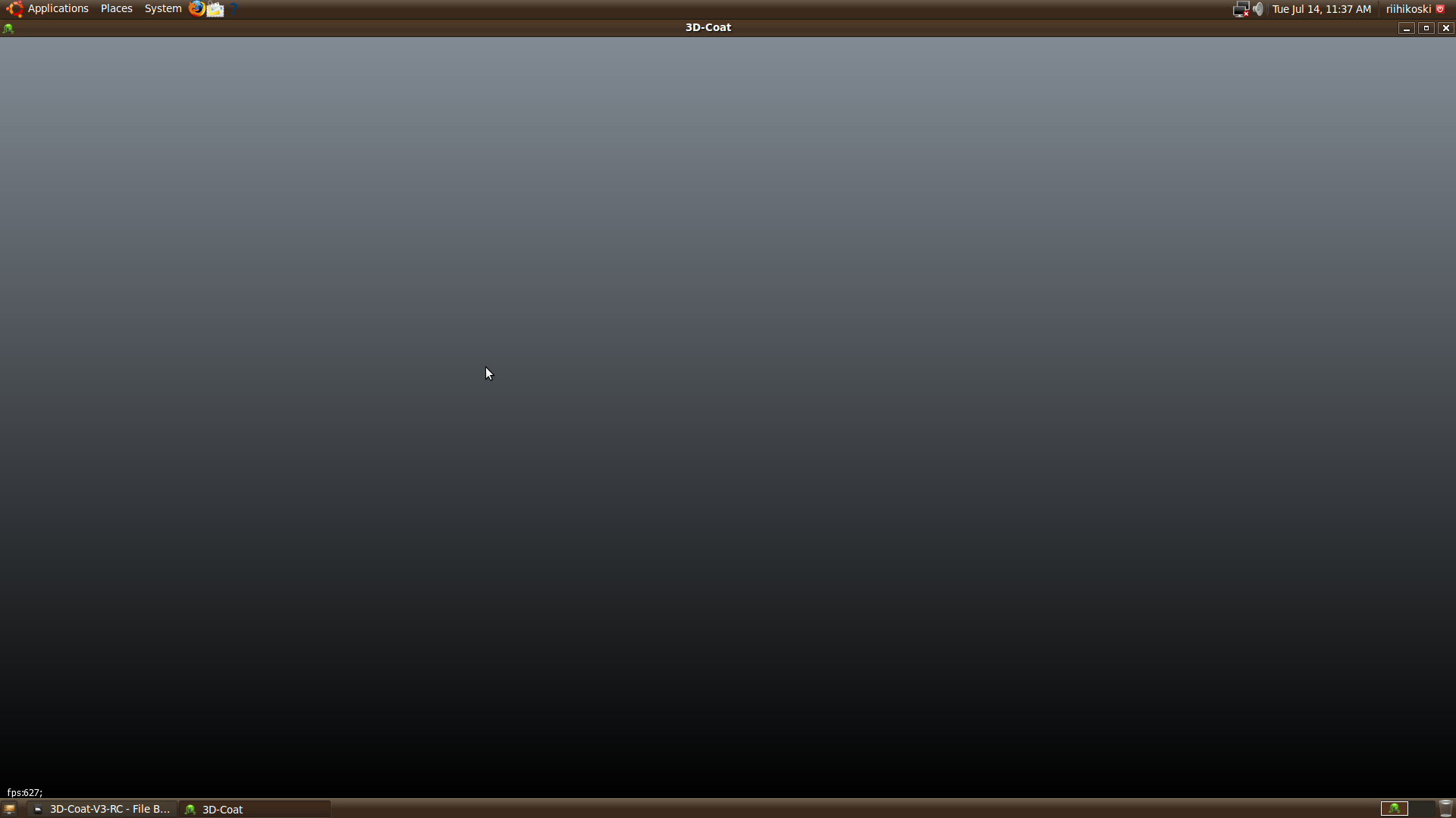

Applink Developer haikalle Posted July 14, 2009 Applink Developer Share Posted July 14, 2009 I used Airbrush tool all the time and I was doing voxelling. I have hard time to re product these bugs in linux but I will try. EDIT: This is wierd. I closed my computer and opended again. Tried to use 3d-coat 64 in linux and all what I get is this screen 3d-coat folder is on Desktop and I use latest Nvidia drivers Link to comment https://3dcoat.com/forum/index.php?/topic/2876-30008-beta/page/17/#findComment-23754 Share on other sites More sharing options...

Advanced Member ghib Posted July 15, 2009 Advanced Member Share Posted July 15, 2009 It could be good if you will show short video or screenshot how it looks. I think I've just discovered the reason behind this bug. Here's a screenshot; As you can see I have the Texture Editor docked to the right of the main viewport and to the left of the side panel with Color Picker etc. It is the docked Texture Editor that is causing the Material to jump to the right everytime I try to distort the image. I also have a feeling it's linked with this Bug I reported a while back. Please have a look at the attached image on that post. I should stress here that the Operative point I make here is; The same thing also happens when you hit HOME to centre the object in your view. In this instance I've drawn (in orange colour) where the correct centre point should be for focussing objects in the 3d viewport. If the Texture Panel is docked then the area highlighted in orange should be the extents of the 3d Viewport. The way it is currently creates problems with centreing objects in the viewport et. Hope it helps Thankyou. Link to comment https://3dcoat.com/forum/index.php?/topic/2876-30008-beta/page/17/#findComment-23825 Share on other sites More sharing options...
