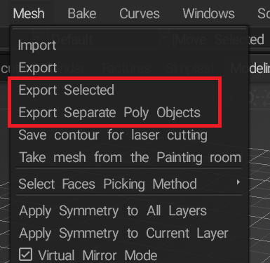

Advanced Member zf3d Posted Sunday at 08:01 AM Advanced Member Report Share Posted Sunday at 08:01 AM Excuse me, how to export a separate drawing room model There are quite a few room models for painting, and I would like to export each model separately Moreover, I found that the model of a re topological room does not have multiple lines with UV settings after export, so the re topological model does not meet the requirements Quote Link to comment Share on other sites More sharing options...
Oleg_Shapo Posted Monday at 09:11 AM Report Share Posted Monday at 09:11 AM On 9/17/2023 at 11:01 AM, zf3d said: Excuse me, how to export a separate drawing room model Try these two commands. Quote Link to comment Share on other sites More sharing options...
Advanced Member zf3d Posted Tuesday at 01:04 AM Author Advanced Member Report Share Posted Tuesday at 01:04 AM 现在又到了制作表情包的时间了,大家有什么好的视频可以推荐吗?客厅里的模型需要调整,应该有雕刻细节,位移贴图,还有大点头 There are some bugs in this feature. Models with heavy topology do not come with udim, while models in the drawing room come with udim Quote Link to comment Share on other sites More sharing options...
Oleg_Shapo Posted Tuesday at 11:15 AM Report Share Posted Tuesday at 11:15 AM 10 hours ago, zf3d said: There are some bugs in this feature. Yes, I checked on the simplest forms. Everything works well. To see and confirm the error, you need a specific scene in 3b format. Quote Link to comment Share on other sites More sharing options...
Carlosan Posted Thursday at 11:02 AM Report Share Posted Thursday at 11:02 AM On paint room you can also export models from Textures menu. Quote Link to comment Share on other sites More sharing options...
