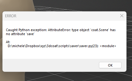

Advanced Member thinkinmonkey Posted February 23, 2024 Author Advanced Member Share Posted February 23, 2024 Hello Carlosan, I receive the following error message: What am I missing? Thanks. Quote Link to comment Share on other sites More sharing options...
Advanced Member thinkinmonkey Posted February 23, 2024 Author Advanced Member Share Posted February 23, 2024 23 hours ago, Carlosan said: Try this ----------------- import coat # Save the current scene coat.Scene.save() By the way, at the moment I'm using the following suggestion from an user in 3DC Discord server: coat.ui.cmd("$SAVE_FILEFAST"); 1 Quote Link to comment Share on other sites More sharing options...
Solution Andrew Shpagin Posted February 23, 2024 Solution Share Posted February 23, 2024 Usually I don't include commands accessible directly from the UI, so this is correct: coat.ui.cmd("$SAVE_FILEFAST"); 1 Quote Link to comment Share on other sites More sharing options...
