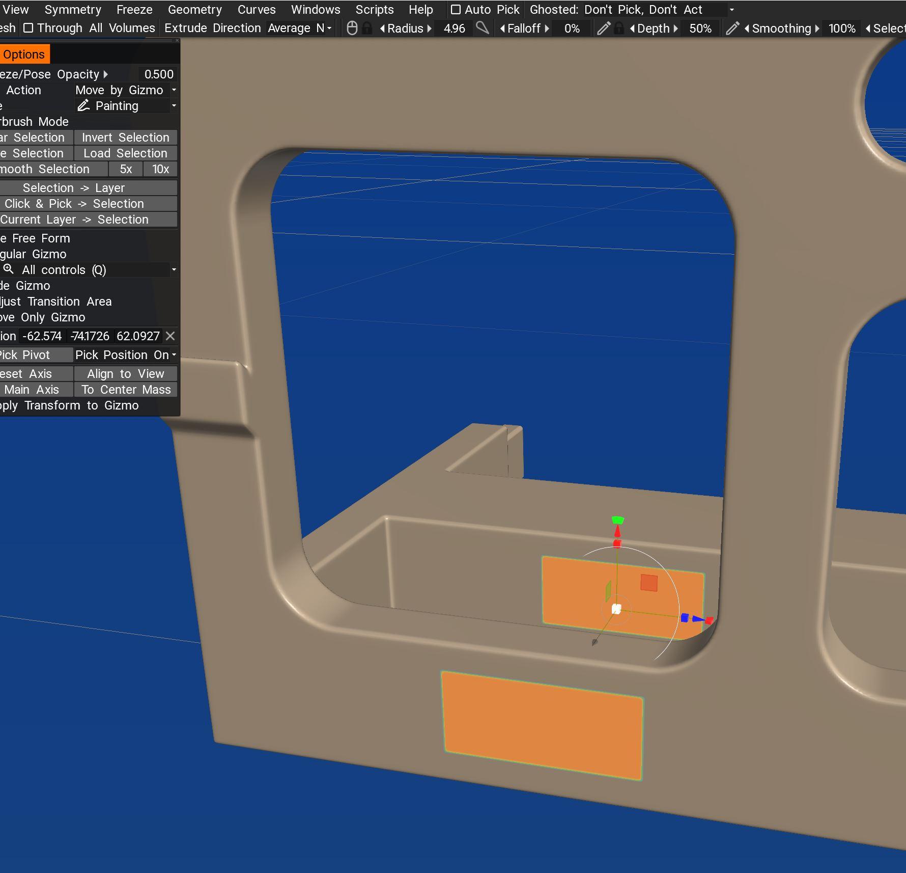

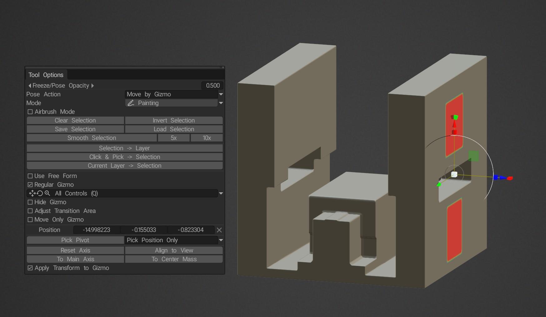

Member splatcreativeau Posted February 9, 2024 Member Share Posted February 9, 2024 How do I prevent the pose tool projecting through to the face behind. Quote Link to comment https://3dcoat.com/forum/index.php?/topic/30029-pose-tool-projects-though-model-to-face-behind/ Share on other sites More sharing options...
Reputable Contributor Solution digman Posted February 9, 2024 Reputable Contributor Solution Share Posted February 9, 2024 Press E on the keyboard to bring up the E-panel Select Ignore Back Faces. Check that no symmetry is on. I forgot myself at times. Quote Link to comment https://3dcoat.com/forum/index.php?/topic/30029-pose-tool-projects-though-model-to-face-behind/#findComment-193207 Share on other sites More sharing options...
Member splatcreativeau Posted February 10, 2024 Author Member Share Posted February 10, 2024 No symmetry, and ignore back faces is checked. Quote Link to comment https://3dcoat.com/forum/index.php?/topic/30029-pose-tool-projects-though-model-to-face-behind/#findComment-193236 Share on other sites More sharing options...
Reputable Contributor digman Posted February 10, 2024 Reputable Contributor Share Posted February 10, 2024 1 hour ago, splatcreativeau said: No symmetry, and ignore back faces is checked. I will see if I can reproduce it and anyone who also helps at the forum can try to reproduce it as well if they have time. Quote Link to comment https://3dcoat.com/forum/index.php?/topic/30029-pose-tool-projects-though-model-to-face-behind/#findComment-193242 Share on other sites More sharing options...
Reputable Contributor digman Posted February 10, 2024 Reputable Contributor Share Posted February 10, 2024 At this time I am unable to reproduce the issue in Windows versions 2023.41 and 2024.06 beta. If happens to me in the course of using the tool, I will report back here. 1 Quote Link to comment https://3dcoat.com/forum/index.php?/topic/30029-pose-tool-projects-though-model-to-face-behind/#findComment-193261 Share on other sites More sharing options...
