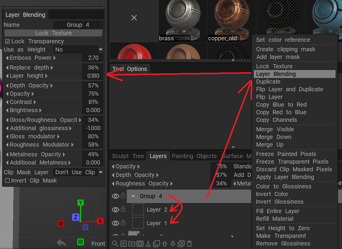

1. When working with retopo layers, it is not necessary to select them. All operations are carried out simultaneously on all visible retopo layers. Or you can select an area with selected Faces/Edges/Vertices and work on all retopo layers.
Paint layers can be combined into a group and some joint operations can be done.
