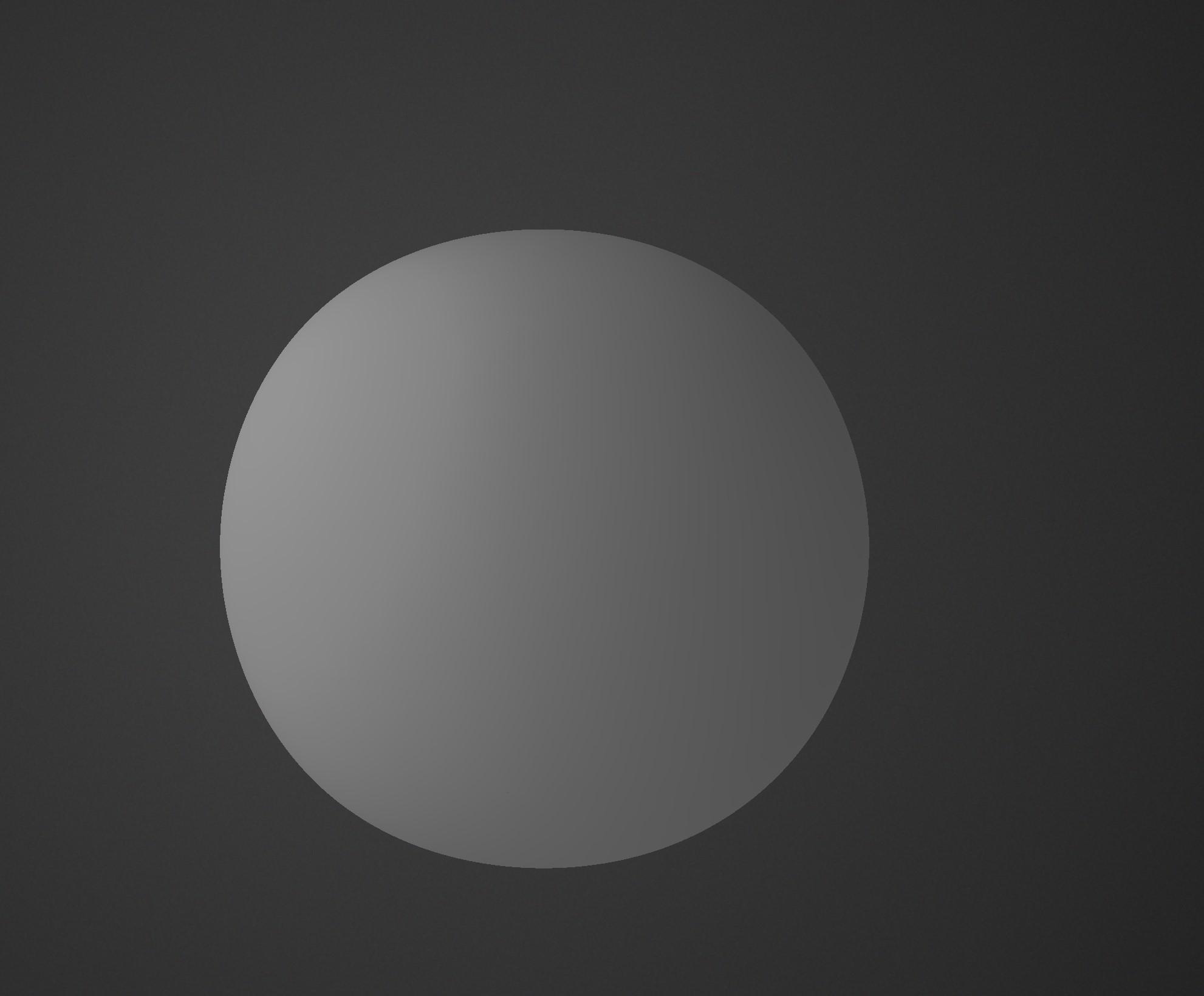

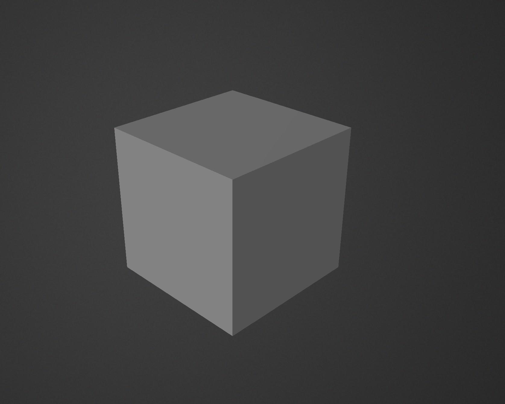

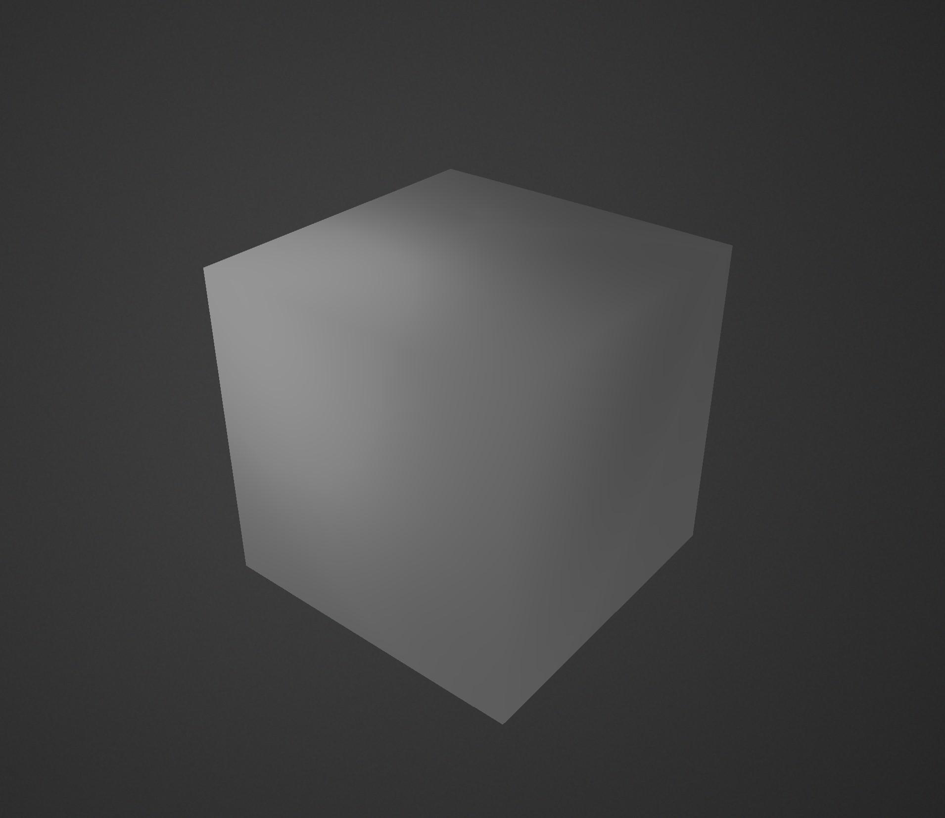

I did a fresh install Blender 4.5.3. The app is broken. I'm using 3dcoat 25.09.  Using the cube as a simple import it appears in 3dcoat (Per-Pixel Painting) it appears as if base color or normals are missing.
Import by Microvertex Painting it appears as a sphere (no sub added). Smart Material is broken using imported object. Everything works in Blender 4.4.
Attached screen shots from 3dcoat.
First picture 3dcoat image Blender 4.5.3
Second picture 3dcoat image Blender 4.4
Third picture 3dcoat image Blender 4.5.3
Edited by Britain
On another note with Blender 4.5.3 you can still use exported objects as .obj and 3dcoat can still use them.

Fixed. Newer version Blender 4.5. Object needs Shade Auto Smooth, Click ignore sharpness and apply the modifier. Now can be used in 3dcoat (using 3dcoat applink). There maybe other ways (hardops)  but this works for me.
