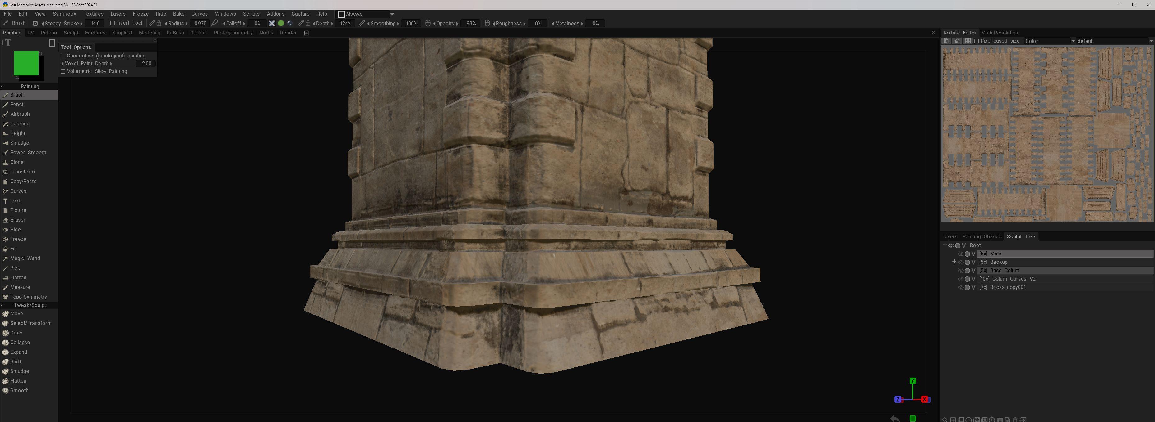

New Member SKYRIXDreamer Posted September 2 New Member Share Posted September 2 So i recently began to use 3Dcoat in my workflow, and bought the 2024 version of the software. I'm currently using the 2024.26v and have been following some courses online to learn how to use it properly. However, when the course goes to the texturing process and i try to follow, 2 things happened. First, when i try to use a smart material after i bake the AO and cavity maps on to the assets, the mouse won't paint even though i have the right tool selected, the left mouse button pans around, and right mouse button zooms. Not sure if this is a glitch but in order to make it work, i have to go back to sculpt mode, select a random object, go back to painting and it works. I tried other ways to fix it but, that was the only solution that worked until now. All the objects that i want to paint on, i turned them into surfaces after working with voxels. Second, the objects that i made in the same project are a lot, and i was going to texture some first, then some others by parts. But now that i want to start texturing the next couple of objects it wont do it, i can only texture the ones that i textured first, but not the next ones. Not sure if I'm sup post to click on something else, or there is a new option that the course that I'm following doesn't have, because its a previous version of the software, or if it's a glitch, i can't tell since I'm new to this software. But after i start this project again, the objects that i want to paint to, display a red color for some reason. Can i get some help please? Thanks Quote Link to comment Share on other sites More sharing options...
Oleg Shapov Posted September 2 Share Posted September 2 2 hours ago, SKYRIXDreamer said: the mouse won't paint Please send a scene in .3b format with an object on which you cannot draw. Quote Link to comment Share on other sites More sharing options...
New Member SKYRIXDreamer Posted September 2 Author New Member Share Posted September 2 Here it is. Hope its an easy fix. demo.3b Quote Link to comment Share on other sites More sharing options...
Oleg Shapov Posted September 3 Share Posted September 3 12 hours ago, SKYRIXDreamer said: Here it is The open scene does not look like your screenshot. Unfreeze all objects with hotkeys Ctrl +D and you will be able to draw. Quote Link to comment Share on other sites More sharing options...
New Member SKYRIXDreamer Posted September 3 Author New Member Share Posted September 3 I know the scene wasn't the same as shown but i had only 9mb i believe of space to upload. but thanks for the help! It works now!!! i still the problem with the smart materials that i mentioned, not sure if its a bug. How do you pull out that Freeze window? I'm using the freeze tool but I'm not sure how you did it. Thanks again for the help. Quote Link to comment Share on other sites More sharing options...
Oleg Shapov Posted September 4 Share Posted September 4 12 hours ago, SKYRIXDreamer said: How do you pull out that Freeze window? Move the mouse cursor over the two dividing lines, hold down the left mouse button and drag the window to the desired location. Quote Link to comment Share on other sites More sharing options...
Oleg Shapov Posted September 4 Share Posted September 4 12 hours ago, SKYRIXDreamer said: i still the problem with the smart materials that i mentioned, not sure if its a bug There is some confusion in this scene. There are objects but no UV map names for these objects. Maybe that's the problem. Try loading any object from the start menu in a new scene and drawing on it with Smart Materials, will there be any bugs? Quote Link to comment Share on other sites More sharing options...
