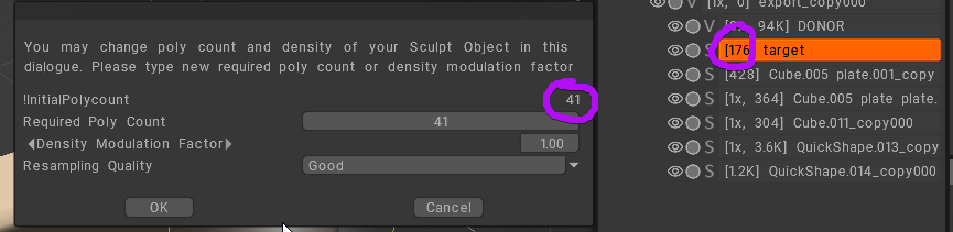

I think my issue comes from the fact that the value in the tree (that's also output by .getPolycount() is not the same as the initial value in the Resample dialog:
So when I run this I'm getting a wrong result.

If I manually put 41 as active_polycount, the resampling is correct. So my question is, how do I get this "initial polycount" value, 41 ?
Or maybe how can I use $ResampleParams::RequiredPolycount instead of ResamplingScale ? Putting any value in it doesn't seem to change anything

Oh, this works. But this seems... weird and wrong?
def ui_command():
    initial_polygon = int(coat.ui.getEditBoxValue('$ResampleParams::RequiredPolycount'))
    resample_scale = math.sqrt(target_polycount / initial_polygon)
    coat.ui.setSliderValue("$ResampleParams::ResamplingScale", resample_scale)
    coat.ui.cmd("$DialogButton#1")
coat.ui.cmd("$Resample", ui_command)
