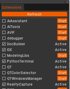

Advanced Member DMG Posted June 24, 2025 Advanced Member Share Posted June 24, 2025 Hello, I'm trying to get this setup, but am not able to use Photogrammetry in 3DCoat. Following the instructions provided: I have downloaded and installed the Epic Games Launcher. I have downloaded RealityScan. I have used Reality Scan as an external app. I have selected RealityScan as the photogrammetry engine in 3DCoat, and set the path to the engine. However, I still don't see the options for shots to 3D or video to 3D. I have checked Windows: Panels: Extensions, and RealityCapture is active. Any thoughts? Regards, Derek Quote Link to comment https://3dcoat.com/forum/index.php?/topic/30961-how-to-install-reality-capture/#findComment-199875 Share on other sites More sharing options...

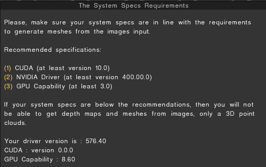

Carlosan Posted June 24, 2025 Author Share Posted June 24, 2025 Maybe this ? Quote Link to comment https://3dcoat.com/forum/index.php?/topic/30961-how-to-install-reality-capture/#findComment-199881 Share on other sites More sharing options...
Advanced Member DMG Posted June 24, 2025 Advanced Member Share Posted June 24, 2025 Hi Carlosan, Yes, that's the panel I remember from when the photogrammetry room was introduced. I couldn't use it at the time, because I don't have CUDA installed. (And I don't think my laptop has room for it.) I thought the RealityScan was a different engine to the initial feature, and hoped that those spec requirements no longer applied, especially seeing as how I can run two other photogrammetry programs (3DZephyr and RealityScan) without it. Regards, Derek 1 Quote Link to comment https://3dcoat.com/forum/index.php?/topic/30961-how-to-install-reality-capture/#findComment-199882 Share on other sites More sharing options...

Carlosan Posted April 29 Author Share Posted April 29 Hello RCapture extension must be turned on (Windows > Panels > Extensions) Is it ? Quote Link to comment https://3dcoat.com/forum/index.php?/topic/30961-how-to-install-reality-capture/#findComment-204620 Share on other sites More sharing options...
