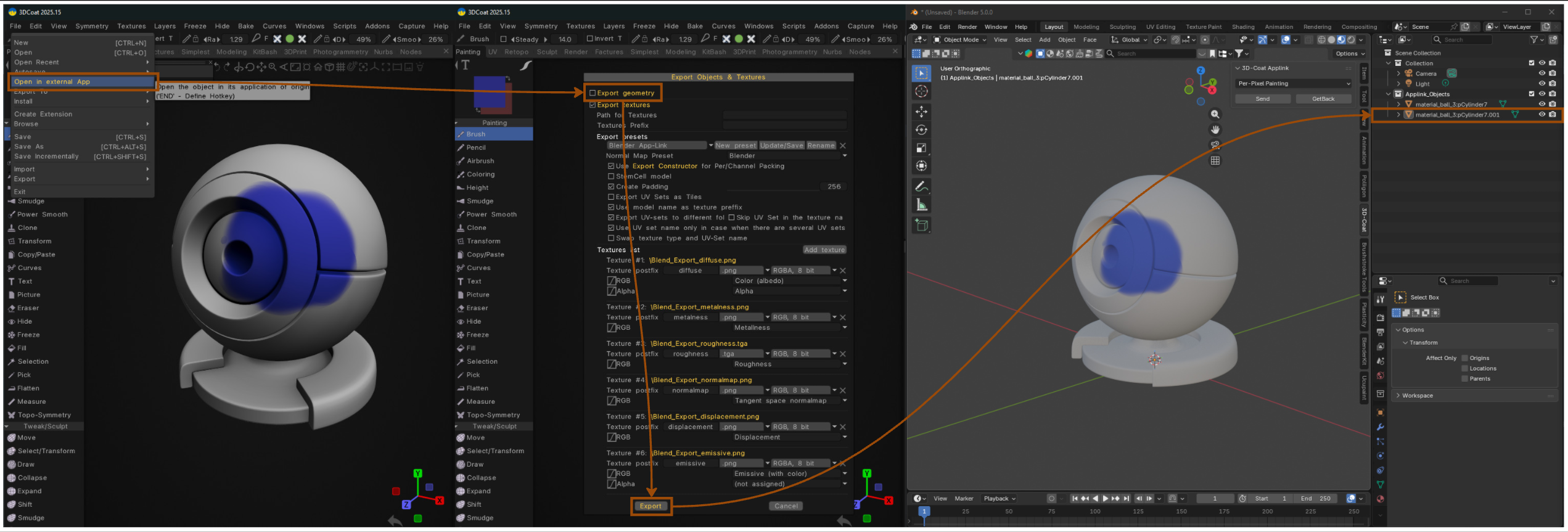

New Member TemporalClockwork Posted December 3, 2024 New Member Share Posted December 3, 2024 So in Blender I hit send on the 3D-Coat Applink Tab for PPP(I've tried other modes aswell). In 3DCoat I apply the model. I then paint the model to change it up a little. At first I tried Export to blender But it crashes without fail every-time. So I tried open in external app and export as FBX to the file that's created by the Applink plugin in Blender. When I switch over to Blender, Blender automatically import the FBX as a new model. This happens every-time I change something in 3DCoat and export. This is the problem When I hit GetBack it updates the material, but nothing else such as moved vertices in the modelling room. How do I get the applink to work without re-importing new models, and actually update my original model? Is this a bug? or am I missing something. I've spent multiple days just trying to get the applink working. 1 Quote Link to comment https://3dcoat.com/forum/index.php?/topic/31028-fixed-blender-43-applink-creates-new-objects/ Share on other sites More sharing options...

Member 45cend Posted November 29, 2025 Member Share Posted November 29, 2025 Apologies for being annoying with this. I had hopes this will have been resolved with the Blender 5.0 update, but it still persists. Could you please let us know what priority level the fix is given. With large projects this is rather a significant issue, as texturing is an iterative process and after several rounds of exporting blender gets polluted with redundant geometry pretty quickly. Just to re-iterate, when re-exporting textures of the same object it would be nice if new material is assigned to the originally exported object - for situations when "Export texture" is enabled and "Export geometry" option is disabled. So the bridge always 'remembers' what object is being worked on as if blender is a continuation of 3DCoat as one of its rooms (I know it's a bit more complex than that in reality xD). Thanks for attention! 1 Quote Link to comment https://3dcoat.com/forum/index.php?/topic/31028-fixed-blender-43-applink-creates-new-objects/#findComment-201912 Share on other sites More sharing options...

Member 45cend Posted November 29, 2025 Member Share Posted November 29, 2025 Hey Carlosan! Thanks for a speedy response! The link itself is working. The video shows the exporting of a Vertex Painted sculpt and it's imported only once there, but this was not the issue. We were discribing a scenario where we would export an unwrapped mesh from the Painting room to Blender, make changes to textures in 3DCoat and re-export to Blender. In this case it would carry over a new mesh instance to Blender even with the export geometry option is disabled. Blender will treat this as a new object and append 00# suffix to its name. In my understanding the Applink should recognise that it's the same instance unless the output mesh is given a different name or the connetion between two apps is aborted. 1 Quote Link to comment https://3dcoat.com/forum/index.php?/topic/31028-fixed-blender-43-applink-creates-new-objects/#findComment-201916 Share on other sites More sharing options...

Reputable Contributor Solution AbnRanger Posted December 3, 2025 Reputable Contributor Solution Share Posted December 3, 2025 2 hours ago, Britain said: App isnt working. I can send from Blender paint, modify then get back. The textures appear but not the modifications. The .fbx model with the mods is sitting in the 3dc2blender/applinks folder. Its not being brought into blender but the textures are. I read others are having the same issue. In any case the applinks folder gets cluttered if you dont keep an eye on it. Should have an option to delete file contents on open in external app from 3dcoat. Nuff said. Just import-export works for me. The above info supplied is from 2022, blender has changed so has 3dcoat. I wont invest up grading to 2025.15 until app can work with other 3dcoat versions such as 2025.09. That's the issue. BLENDER broke their addon structure around 4.3 and every addon developer had to scramble to get their addons working again. The GitHub file helped partially, but Andrew had to re-write the addon to make it work fully. I had some troubles initially (build 2025.12), but after a fresh install of 3DCoat (2025.12) + Blender 4.5 + add 3DCoat and Blender to my system's firewall and antivirus exceptions list, it finally worked. Quote Link to comment https://3dcoat.com/forum/index.php?/topic/31028-fixed-blender-43-applink-creates-new-objects/#findComment-202152 Share on other sites More sharing options...
