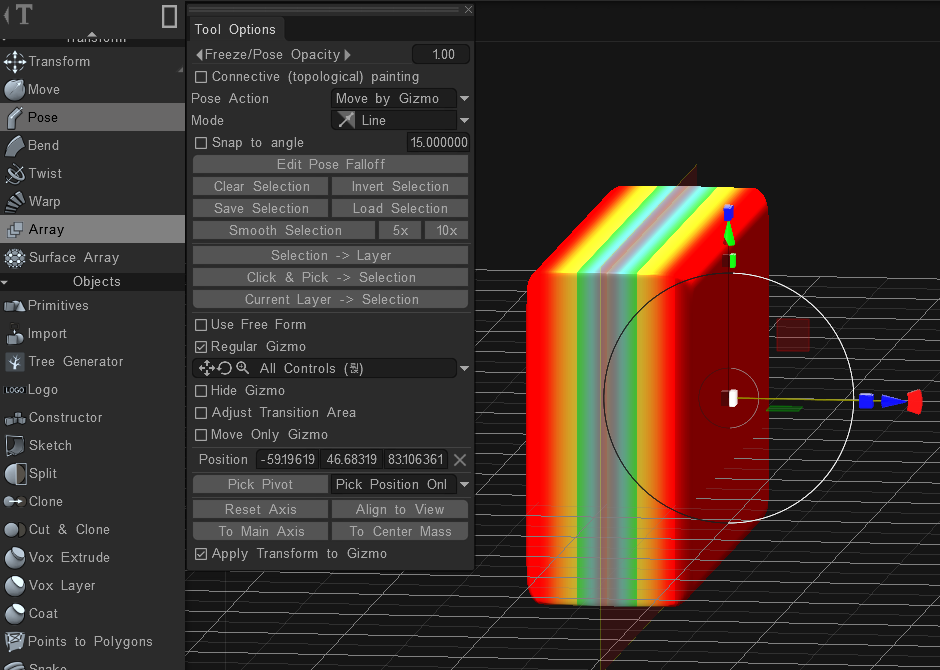

Member RN3000 Posted February 8 Member Share Posted February 8 Hi, I'm new to 3DCoat but have experience with 3D modeling in Blender and ZBrush. I'm running into an issue and could use some help. Here are the steps I followed: Activated symmetry on the X axis Used the 2D Paint brush to drag out a square Selected the shape with the Transform tool and scaled it along the X axis Based on my experience, it seems like there might be a problem with normals or shading, but I haven't been able to fix it. Could you help me troubleshoot this or point me in the right direction? I've attached a screenshot for reference. Thanks in advance! Quote Link to comment Share on other sites More sharing options...
Carlosan Posted February 8 Share Posted February 8 Hello The image you posted is an empty file. Quote Link to comment Share on other sites More sharing options...
Member RN3000 Posted February 8 Author Member Share Posted February 8 hey, oh sorry for that, it should be visible now here https://www.dropbox.com/scl/fi/7w60d06f19c6sszp4njxv/Screenshot-2025-02-08-alle-11.03.16.png?rlkey=ymkm515babpamt2lxaxcddxt2&st=w29splsv&dl=0 Quote Link to comment Share on other sites More sharing options...
Carlosan Posted February 8 Share Posted February 8 Try Pose tool Will give you better result 1 Quote Link to comment Share on other sites More sharing options...
Member RN3000 Posted February 8 Author Member Share Posted February 8 yes, perfect - thanks a lot for your help! 1 Quote Link to comment Share on other sites More sharing options...
